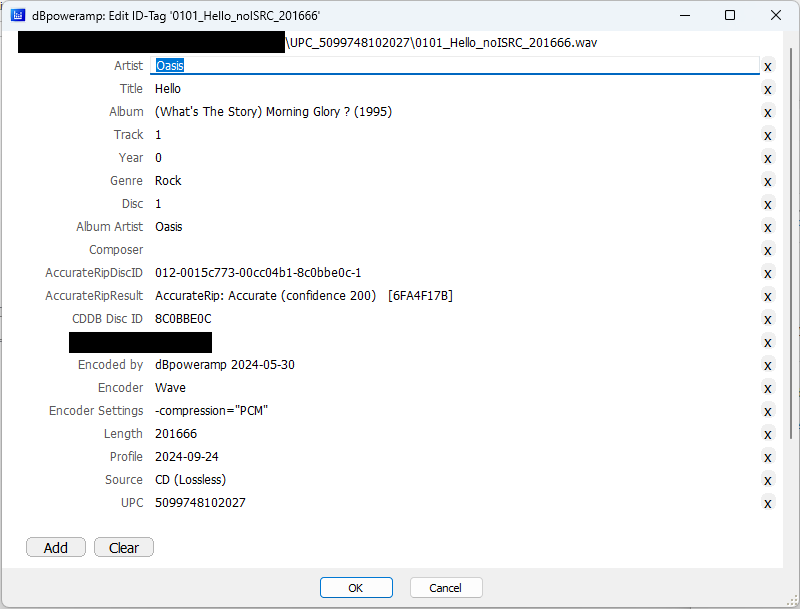

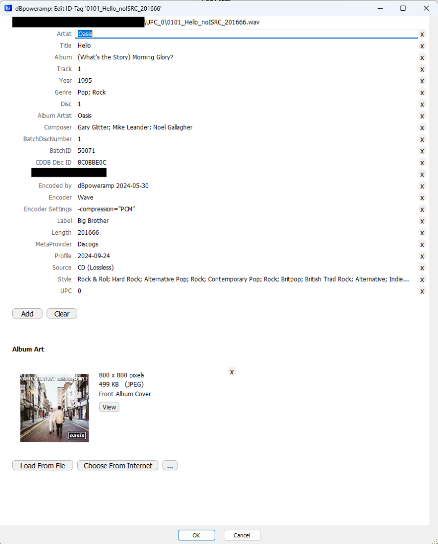

          path:
          \\path\to\files\[IFVALUE]upc,UPC_[tag]upc[],noUPC[].
          These are the results from CDRipper and BatchRipper with the same settings.
          CDRipper:
          Click image for larger version  Name:	UPC_cdrip.png Views:	0 Size:	184.0 KB ID:	328075
          BatchRipper:
          Click image for larger version  Name:	UPC_BR.png Views:	0 Size:	166.4 KB ID:	328076
          Also notice that ISRCs and AR results are not written in BR.

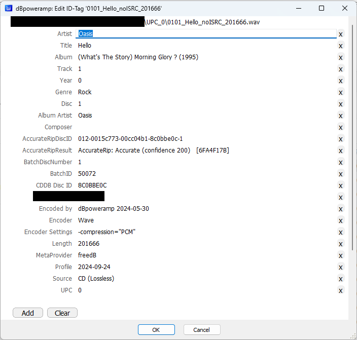

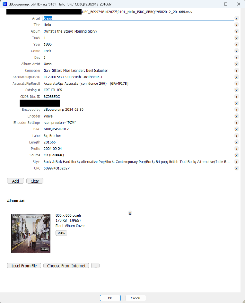

              I tried again by disabling every metadata provider, cache, cdplayer.ini and intelligent lookup. Turns out AccurateRip Meta was providing the ISRC.
              The metadata on this test comes from freedb, CD-Text, CD-ISRC, and CD-UPC, and I have double checked that its the same in both BR and CDripper settings.
              CDRipper:
              BatchRipper:
