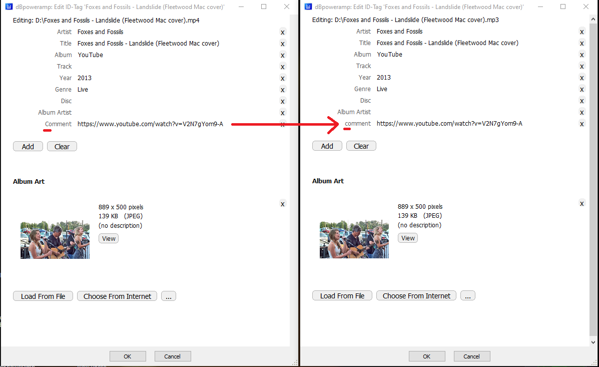

    The only issue I have now, is that the converted files all have the iTunes metadata 'Comment' copied across into the 'comment' field rather than the original 'Comment' field. Unfortunately some Media players won't display the older 'comment' field. They only show what's in the 'iTunes Comment' field.
    I can fix this (after conversion) by using the dBpoweramp 'Edit ID Tags' right-click function, by slightly editing the 'comment' field (just enough to trigger a change) and then re-saving, which copies the text over to the correct 'Comment' field, but it means I have to manually do it for every converted file.
    So, is there something I can add to my Custom command to fix this, or another filter, or DSP effect that I can add in, so that it can be automated, or will it always require another step after the first conversion process?
    This image shows my issue: Click image for larger version
Name:	mp4 to mp3 conversion.png

      OK, so I worked out that I can modify the iTunes "Comment" ID tag by using the "ID Tag Processing" DSP Effect with the dBpoweramp Music Converter, by utilising three stages. ie. Mapping "Comment" to "Copyright" (which I never use), then Mapping "Copyright" back to "Comment", and finally doing a Single Tag Deletion of the "Copyright" tag.
      This has the benefit of updating the missing iTunes "Comment" tag from the older "comment" ID3v1 tag.
      Perfect.
