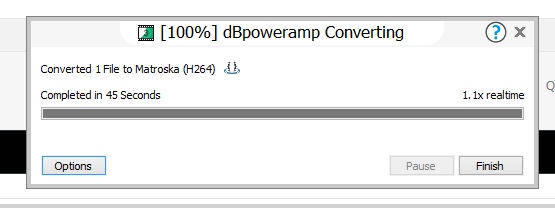

            Re: Video converter not working
            Try this, download a sample video file from:
            The top one, then convert to 'Matroska (h264)', no dsp effects, does it create the Matroska file? (it should take 60 seconds to convert it).
            • bkTerry
              • Mar 2019
              • 8
              Thanks Spoon. Did exactly as you suggested. The conversion bar sat at the beginning of the bar for 44 seconds, then shClick image for larger version
ID:	294043ot across to the far right and said finished, but no file created.
                Try starting windows in safe mode, then do the conversion.
                • bkTerry
                  • Mar 2019
                  • 8
                  Hi Spoon, thanks, that worked fine. A 45 minute video took 15 minutes to convert. What does that tell me, and how to make it work in normal mode?
                    It means you likely have some security software which is blocking the conversion.
                    • bkTerry
                      • Mar 2019
                      • 8
                      Thank you Spoon, Comodo had all dBpoweramp blocked. Fine now. Great help service.
