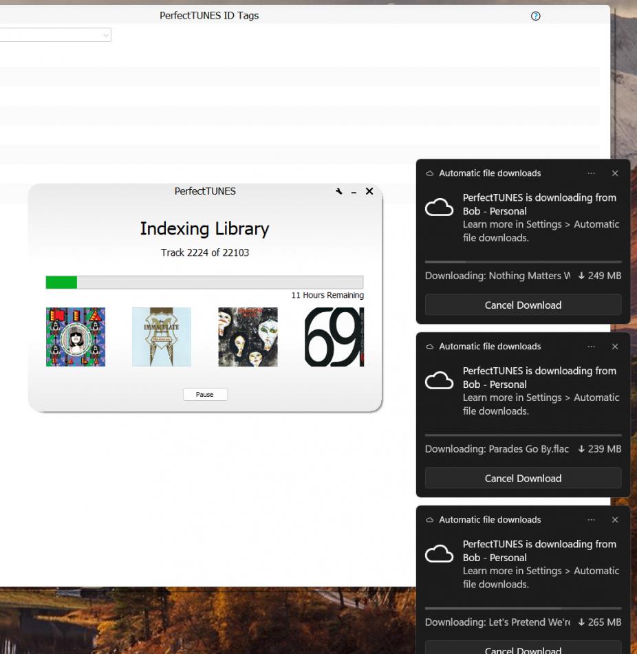

              Thanks, I'm going to uninstall/reinstall. The behaviours I'm seeing seem odd. I've tried to attach a screenshot to show the sort of thing I'm getting (Not sure if the image will appear). Downloading a file multiple times larger than the actual music file itself is definitely not right.
Name:	Screenshot 2023-12-05 052156.jpg

                I keep all of my music files on my D Drive, except I have a few hundred favourite albums on OneDrive. By default PerfectTunes lists the User\Music folder as a source. That folder is actually a OneDrive folder, so whenever I do anything on PerfectTunes it trawls through OneDrive first (quite why it sees such massive files I have no idea). I've deleted the 'Music' folder and pointed PerfectTunes only to the relevant D Drive folders. It's now running the way I was hoping.

                  aha. After looking just now at your pictures, I started to suggest that maybe you are trying to analyze files that are in some sort of cloud drive and thus the downloading. But good that you solved this mystery first.
