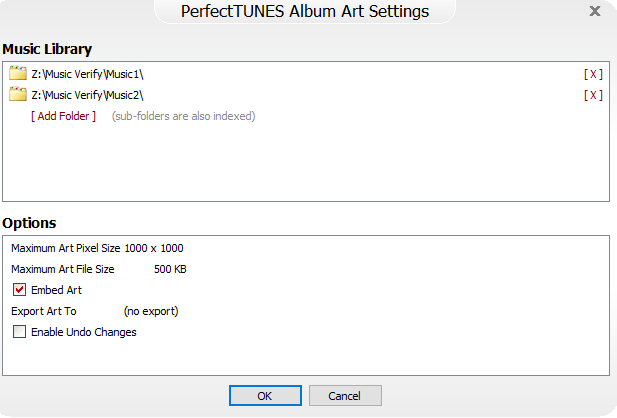

            So perhaps not what you are asking for precisely but in my experience if you configured PerfectTUNES Album Art to set your maximum art pixel size it is honored when selecting new art work. I have mine set to 1000x1000 and if I choose a new one during search of greater dimensions it is resized as it is saved to the files.
