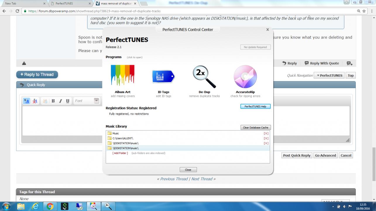

              Here is a screenshot as requested. As you see, DISKSTATION/Music is indicated. I left it running overnight, and it seems to to have connected to that library. It has now corrected the album art. I am not sure what the problem was. Maybe it was just very slow - although there are only about 40 cd albums in the library. Possibly, it will help if I plug my computer directly into the NAS drive.
              My concern about mass deleting duplicates remains. As far as i can see, everything I have put in my DISKSTATION music library has been duplicated. There are two copies of everything showing. My suspicion is that what I am seeing is one that shows in my library when i open it, and one that is on the second WD Red hard drive, which the NAS drive uses for backing up all files. Does that make sense? If so, having two copies of everything in PerfectTunes is OK. However, it would be better if I can do as suggested - i.e. that I do not include the back up files in PerfectTunes. How do I do that?

                DISKSTATION/Music is indicated twice, which might explain why you are seeing duplicates.
                Also, you have configured 2 other locations. Only you will know what is contained in these locations, but if you have copies of your files within these locations, this might also explain why you are getting duplicates.
                If you are sure that your audio files are in DISKSTATION/Music, I suggest you start again, removing ALL locations (and maybe clear database cache). Then, Add Folder again for DISKSTATION/Music, so this is your only indexed location.
                I'm not entirely sure why PerfectTunes allows users to add duplicate locations, but maybe Spoon can comment on this.

                  Thanks. I could try that, but the second configuration of Diskstation was put in only last night. I did that to see if I started again and left it on overnight it would work better. It did.
                  However, the duplicate tracks are the same as they were before. As far as i can tell, no more have been added. It is basically just an extra copy of everything.

                      You should not have your music folder and discstation at the same time, there should be only 1 item listed under library.

                        Many thanks. I have now managed to run mass removal on just my Diskstation and it worked. I also managed to correct the album art. However, 34 files continued to show as duplicated, and when I trued to delete them, a message said I could not do so, and should check if I have permission. I assumed that was because of some sort of 'fix' I had used. So - perhaps unwisely - I clicked 'clear data base cache'. That certainly worked in removing the duplicates, but it also means that no albums at all now appear in PerfectTunes. The stuff is still in my music library. Can you explain what i have done? Is is a problem.
