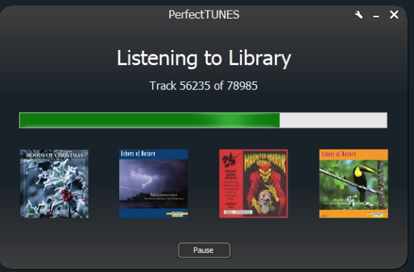

Name:	Screenshot 2025-12-29 145333.png
ID:	336982 Sorry this is taking so long. The new executable is taking several hours to index the tracks. It's still only about 2/3 done. Accuraterip does say "listening to library" so far and the album art is moving in fours. Attached is where I am now.
