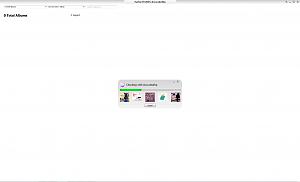

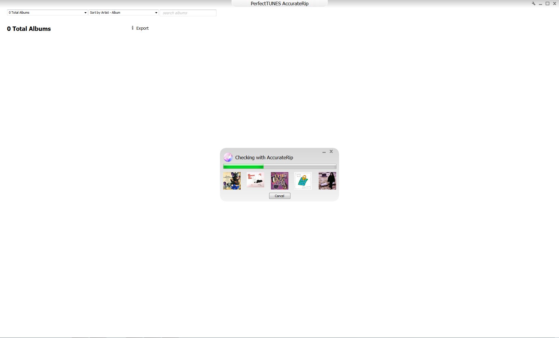

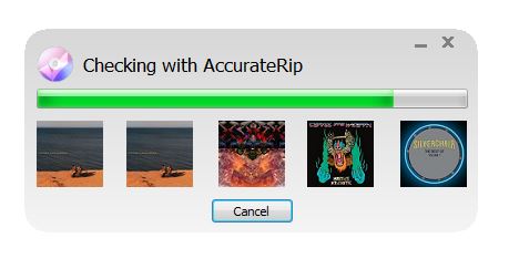

    However, the program freezes (ie does not progress any further into the library) at the same point every time (I have repeated it three times, always stalls at the point shown in the attached photo "PerfectTUNES stall"). I thought it may have been the library was too large, so I split it into two folders (artists A-N and O-Z) and did each separately, but it froze at an even earlier point (see photo "PerfectTUNES A-N").

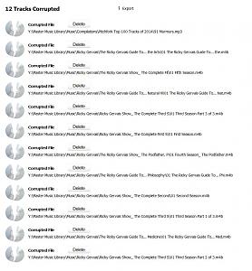

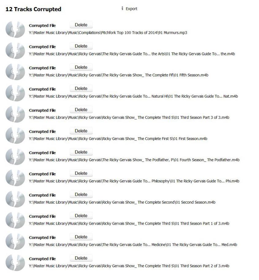

    There were also some corrupted files shown after I cancelled the operation when it stalled (see photo "PerfectTUNES corrupted") but the corrupted files do not have any relevance to the point that the operation stalled.

    Run Batch Converter >> Test Conversion to determine anymore corrupt files in your library.

      If you click cancel then reload the program, it should quickly carry on where it left off.

        Hi, here are the results, there were no additional corrupt files in the library:
        Error converting to Test Conversion, 'Y:\Master Music Library\Music\Compilations\Pitchfork Top 100 Tracks of 2014\91 Murmurs.mp3' to 'Y:\Master Music Library\Music\Compilations\Pitchfork Top 100 Tracks of 2014\91 Murmurs.IGNORE'
        Error decoding mp3 data stream, is corrupt?
        Error converting to Test Conversion, 'Y:\Master Music Library\Music\Ricky Gervais\Ricky Gervais Show_ The Complete First S\01 First Season.m4b' to 'Y:\Master Music Library\Music\Ricky Gervais\Ricky Gervais Show_ The Complete First S\01 First Season.IGNORE'
        Unable to decode m4a file (is corrupt or not supported audio type).
        Error converting to Test Conversion, 'Y:\Master Music Library\Music\Ricky Gervais\Ricky Gervais Show_ The Complete Second\01 Second Season.m4b' to 'Y:\Master Music Library\Music\Ricky Gervais\Ricky Gervais Show_ The Complete Second\01 Second Season.IGNORE'
        Error converting to Test Conversion, 'Y:\Master Music Library\Music\Ricky Gervais\Ricky Gervais Show_ The Complete Third S\01 Third Season Part 3 of 3.m4b' to 'Y:\Master Music Library\Music\Ricky Gervais\Ricky Gervais Show_ The Complete Third S\01 Third Season Part 3 of 3.IGNORE'
        Error converting to Test Conversion, 'Y:\Master Music Library\Music\Ricky Gervais\Ricky Gervais Show_ The Complete Third S\01 Third Season Part 2 of 3.m4b' to 'Y:\Master Music Library\Music\Ricky Gervais\Ricky Gervais Show_ The Complete Third S\01 Third Season Part 2 of 3.IGNORE'
        Error converting to Test Conversion, 'Y:\Master Music Library\Music\Ricky Gervais\Ricky Gervais Show_ The Complete Third S\01 Third Season Part 1 of 3.m4b' to 'Y:\Master Music Library\Music\Ricky Gervais\Ricky Gervais Show_ The Complete Third S\01 Third Season Part 1 of 3.IGNORE'
        Error converting to Test Conversion, 'Y:\Master Music Library\Music\Ricky Gervais\The Ricky Gervais Guide To... Medicine\01 The Ricky Gervais Guide To... Med.m4b' to 'Y:\Master Music Library\Music\Ricky Gervais\The Ricky Gervais Guide To... Medicine\01 The Ricky Gervais Guide To... Med.IGNORE'
        Error converting to Test Conversion, 'Y:\Master Music Library\Music\Ricky Gervais\The Ricky Gervais Guide To... Philosophy\01 The Ricky Gervais Guide To... Phi.m4b' to 'Y:\Master Music Library\Music\Ricky Gervais\The Ricky Gervais Guide To... Philosophy\01 The Ricky Gervais Guide To... Phi.IGNORE'
        Error converting to Test Conversion, 'Y:\Master Music Library\Music\Ricky Gervais\The Ricky Gervais Guide To... Natural Hi\01 The Ricky Gervais Guide To... Nat.m4b' to 'Y:\Master Music Library\Music\Ricky Gervais\The Ricky Gervais Guide To... Natural Hi\01 The Ricky Gervais Guide To... Nat.IGNORE'
        Error converting to Test Conversion, 'Y:\Master Music Library\Music\Ricky Gervais\The Ricky Gervais Guide To... the Arts\01 The Ricky Gervais Guide To... the.m4b' to 'Y:\Master Music Library\Music\Ricky Gervais\The Ricky Gervais Guide To... the Arts\01 The Ricky Gervais Guide To... the.IGNORE'
        Error converting to Test Conversion, 'Y:\Master Music Library\Music\Ricky Gervais\The Ricky Gervais Show_ The Complete Fif\01 Fifth Season.m4b' to 'Y:\Master Music Library\Music\Ricky Gervais\The Ricky Gervais Show_ The Complete Fif\01 Fifth Season.IGNORE'
        Error converting to Test Conversion, 'Y:\Master Music Library\Music\Ricky Gervais\The Ricky Gervais Show_ The Podfather, P\01 Fourth Season_ The Podfather.m4b' to 'Y:\Master Music Library\Music\Ricky Gervais\The Ricky Gervais Show_ The Podfather, P\01 Fourth Season_ The Podfather.IGNORE'

            I MAY have more info: I believe it stalls when it encounters an album that has more than one disc (from looking at the covers and when it stalls, it has stalled on three different occasions at a double album)

                      Fixed this issue by uninstalling and reinstalling! Does my whole library without issue.
