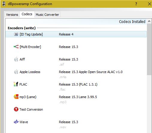

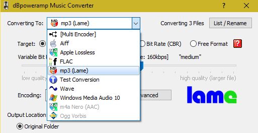

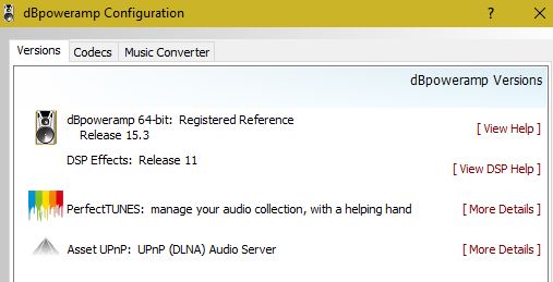

        That makes sense, but "ID TAG UPDATE" does not show up in my dmc "convert to" drop down menu. I've tried uninstalling and reinstalling both dmc and the codec, and tried running dmc as admin, to no avail. As you can see from my screen snips below, it looks like the codec is installed. I'm running Windows 10, 64-bit.

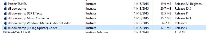

            I did that already. In my "Programs and Features" list, right at the top is "dBpoweramp [ID Tag Update] Codec". Here is a list of my installed illustrate products:

              So it's working now. I had to uninstall all illustrate products, reboot, and then reinstall dmc, the tag codec, and then PerfectTunes. The ID TAG UPDATE now shows up in the "convert to" menu. Thanks for all your help.
