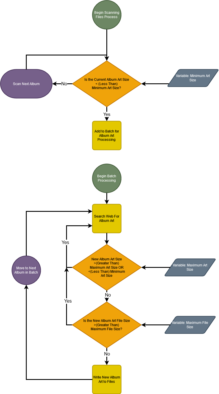

            For additional clarification, here is a basic flowchart of what I'm requesting. The process has been oversimplified for this example. The process at the top is the new feature I'm requesting. The variables you are mentioning are in the lower part of the flowchart. Click image for larger version

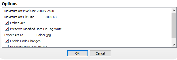

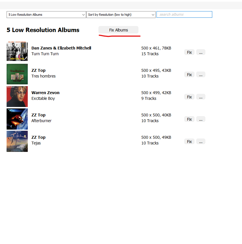

                Thanks for the reply. First yes, this is a paid version and I'm using the latest version available to me. This is specifically for the automated batch processing to "fix" all the "Low Resolution" albums. Here's how it works for me.
                First, I have set the "Maximum Art Pixel Size" to 2500 x 2500 and the "Maximum Art File Size to 2000 KB.

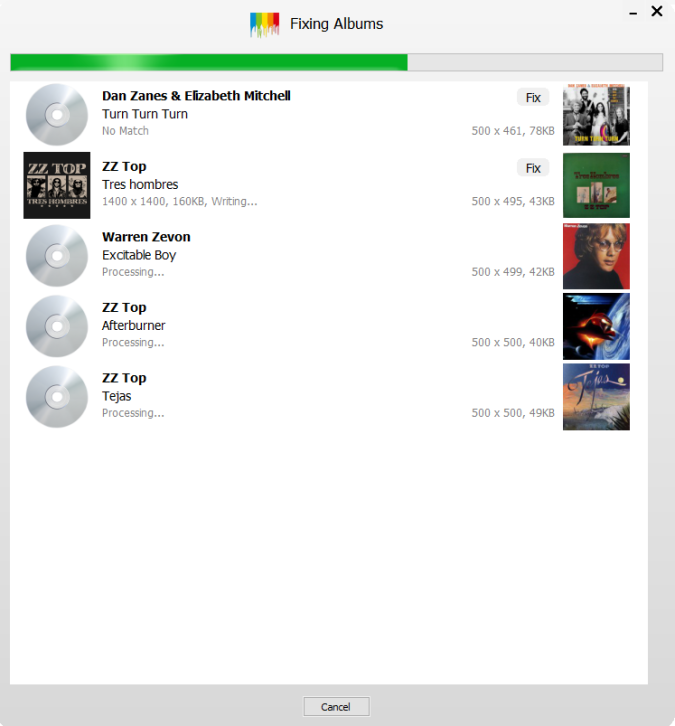

                When I add a music library the software scans the music library and after some time presents me with the screen showing a vertical list of the albums with a thumbnail of the album art with the current pixel size to the right. If I select the dropdown at the top and select the "* Low Resolution Albums", I'm presented with a "Fix Albums" button which kicks off the batch process of automatically searching for larger album art files, limited by the afore mentioned settings. I'm always able to click the individual "fix" buttons that are adjacent to each album in the vertical list to manually select a better option.
                What I'm specifically asking for is a variable by which to define what is considered to be "Low Resolution Albums". In searching this forum I've found indication that this is hard coded as anything below 600 X 600 as "Low Resolution". This seems to be arbitrary. The request is to make this setting user adjustable similar to the "Maximum Art Pixel Size". This same setting could be utilized in the batch process to limit results that would be below this setting as well.

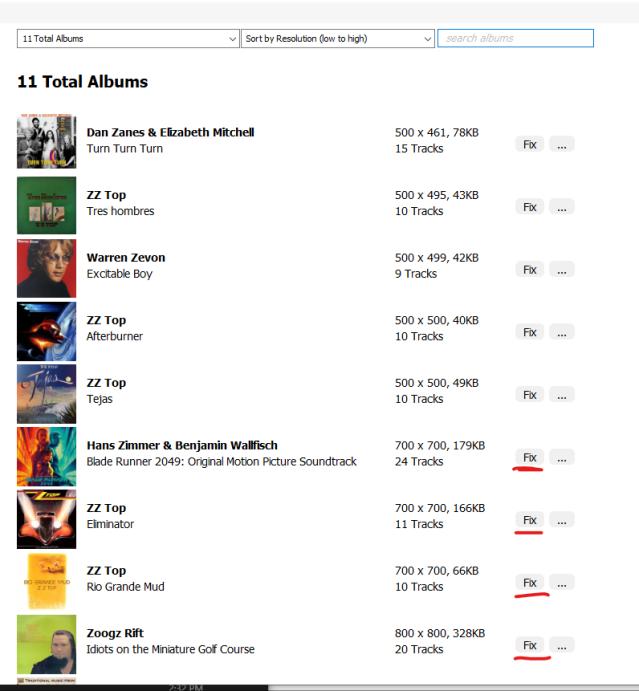

                In the current state, after it batch processes all of the "Low Resolution" albums and I make adjustments manually as needed, I need to go to the main screen, select the "Total Albums" dropdown, then select the "Sort by Resolution (low to high)" from the second dropdown, then manually select the "fix" button and manually select the album cover I want for that specific album. I repeat this process until I've updated all of the artwork in the list of albums that is 600 x 600 up to around 1000 x 1000, or my spirit is broken, whichever comes first.

                Fig 1 Settings:

                Fig 2 Low Resolution Albums:

                Fig 3 Batch Fixing Albums:

                Fig 4 Manually Fixing The rest of the Albums:
