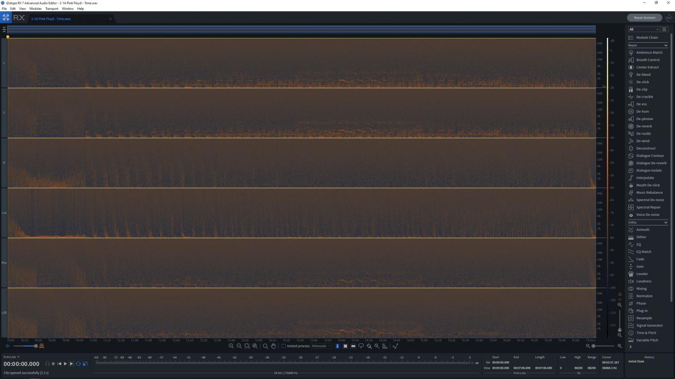

        Here's what it looks like in spectral view for reference when I try to convert to PCM (WAV or AIFF).
          Re: DSD (DSF) 5.1 Files
          The file you provided converts fine to wave (latest version of dBpoweramp on Windows).
          Ensure in dBpoweramp Control Centre >> Audio Codec settings that under DSD Decoder
          DSD Processing is 'Decode to PCM'
          Decoding Down Sampling is 96Khz
          and 24 bit
