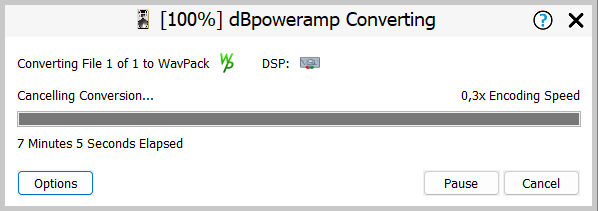

i'm trying to convert stereo wav file with VST3 plugins ToneBoosters.
and notices an issues:
The conversion process reaches 100% and does not end.
I tried opening different audio formats, after converting, that failed to fully complete, and only a few of them were able to open as incomplete.
For example WV format, however, when I open an audio file in the player, I can clearly hear a strange sounds like clicks with multiple repetitions.
Also, i tried to convert 5.1 audio file with VST3 and got message:
However, when i open audio file stereo or 5.1 for example in "Acoustica" audio editor and apply VST3 plugins "ToneBoosters" - everything works fine with 5.1 and stereo.
and there are no clicks with reverberation effect.

Thank you for adding VST plugins support,
VST refused audio format [clDSP::BeginConversion]
VST expects 2 channels (stereo) [clDSP::BeginConversion]
