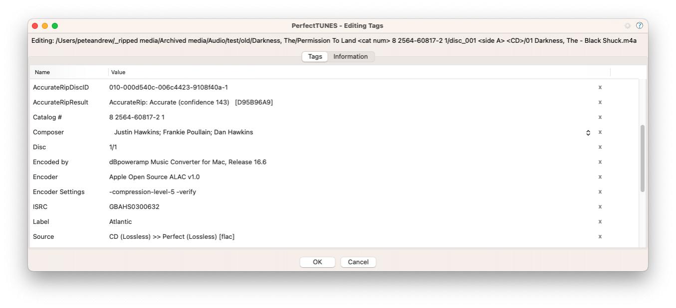

      Regarding the tools I used (and if it was/was-not done via dBPoweramp), this is the only information I could find Click image for larger version
Name:	Screenshot 2023-01-30 at 9.37.00 AM.jpg

        Re: Is there a reason the latest dBPoweramp tools clamp "m4a FDK (AAC)" at 512 kbps?
        AAC is a lossy codec, converting to 128, 512, or any value results in quality loss, how much depends on bitrate.
