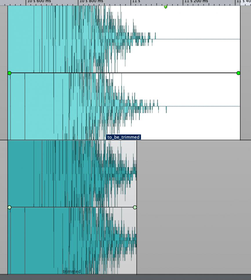

    Hello,
    i can't get the trim silence dsp in the converter to work properly.
    i specify "trim silence at end", "digital silence '0'" and "detection threshold=50ms".
    But non '0' audio at end is cut anyways. Please see attached picture that shows the 'trimmed.aif' vs 'to_be trimmed.aif' in wavelab with vertical zoom in and the soundfile itself.
    thank you!

    It almost looks like the 50ms window got cut at the start of the analysis instead of the end of analysis...
