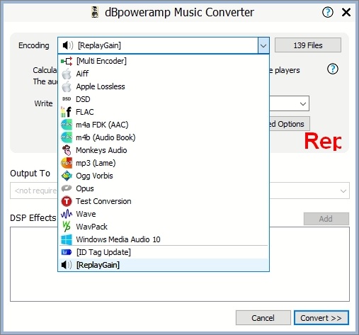

            Something doesn't add up...
            On the Encoding dropdown list, I only have ReplayGain

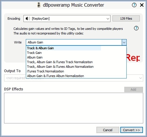

            Then there are some more options under the Write dropdown list, I chose Track & Album Gain

            All this time the Add button next to the DSP Effects remains grayed out.
            What am I doing wrong? How can I add ReplayGain (Apply) DSP?

              Sorry, I've misled you a bit on this (as I don't ever use ReplayGain(apply). I've now looked more carefully and suggest the following steps. There may be a way to combine these steps to simplify (do the RG tagging and applying in one step), but this is how I'd do it:
              1. Load up all your files in Batch Converter, and convert to REPLAYGAIN DSP (from the dropdown list). In the options for ReplayGain, I'd choose: Track & Album gain, EBUR128, -18LUFS, and do NOT tick disable clip prevention. (note, EBU R128 is still writing replaygain tags, just a more modern algorithm)
              2. At this point you've written ReplayGain tags (metadata) to all your files. The next step will be "applying" the RG info to actually change the audio itself in these files. So you'll be writing new mp3, flac, Alac, etc. files at this point. If you want to convert your mp3 to mp3, flac to flac, etc., then you'll need to separate your files in some way (file explorer search, filtering, etc.)
              3. Let's say you have a bunch of mp3 files, you will now do Batch Converter, select CONVERT and choose mp3(lame) from dropdown list. Then choose the level you want (-V2, -V1, -V0, etc.). Note redoing a lossy file (mp3, aac, m4a) will lose quality. It is unlikely noticeable). On the other hand, redoing a lossless file (flac, alac, wav, etc.) will not lose any quality.
              After you've chosen what codec you want to convert to, in the popup box, chose ADD to add a DSP. Then add "ReplayGain(apply)" dsp. In the settings for this DSP, choose either Track or Album depending on which RG value you want to use. ALBUM RG values maintains volume differences between songs on the SAME album. TRACK RG values ignores intra-album volume differences and tries to make every song sound the same volume (this used to be called "radio" RG, as that is how one hears songs on broadcast radio....all the same relative volume.
              4. on the conversion popup, there is a row for setting where you want these new files written. If you want the new files to have the exact same path (artist/album etc.) and same exact file name, then (a) click on the dropdown menu and select "edit dynamic naming", then select a base location (other than your existing files, as you don't want them overwritten). So if your current files are in c:\users\yourname\music, select something like c:\users\yourname\NEWMUSIC. Then below this, in the dynamic naming box, use this:
              [origpath]\[origfilename]
              5. When all this is set, bottom right of this popup, select CONVERT.
              Obviously test all this on a few files/folders first before you apply to your entire 4,000 files.

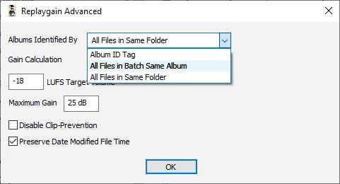

                Just one more thing, what do I choose in the Album Identified By menu, All Files in Batch Same Album?

                  Assuming your files all have the metadata ALBUM field completed (name of album), then I'd choose "Album ID Tag"
