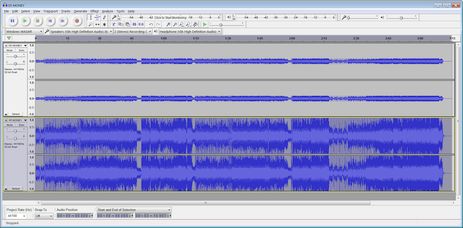

                  I have the same problem with recently purchased m4a files (from iTunes).
                  Here is Audacity screenshot.
                  Top is the converted FLAC, bottom is the original m4a.
                  dbPoweramp is version 16.6 64bit on Windows7
