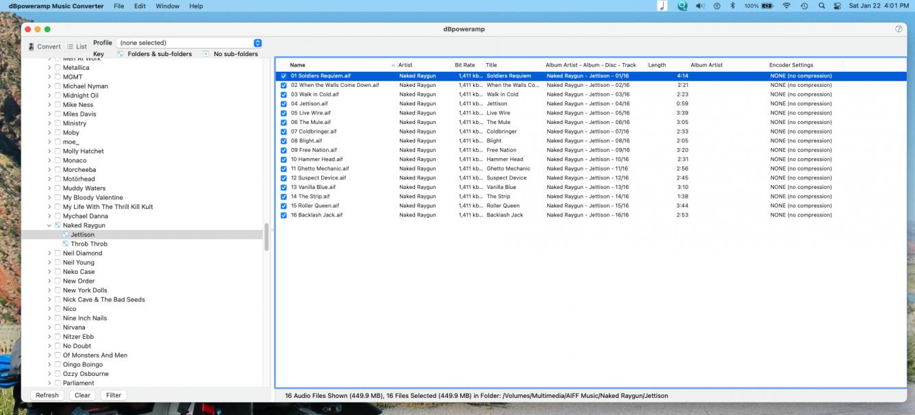

              I'm on a Macbook Pro in the batch converter looking at the files. There's all sorts of fields that I can select and I seen encoder settings and encoder in the extended properties.I tried to attach an image of my screen but vB is not being helpful.

                  Launch Batch Converter, select files (as you seem to have done in your jpg image) and then click the Convert button.
                  In the following window you can select the ID Tag Update utility codec, if it is installed.
                  These instructions are based on my use of dBpoweramp for Windows and I assume it is the same process for the Apple OS.
