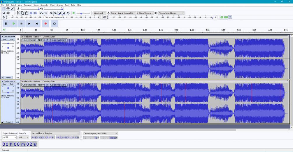

                  I have the same issue. Files I buy on itunes and convert to any other format (wma wav mp3) using db converter create blank spots. In the photo the top one is itunes original the bottom one is after converting in dbpower to mp3, there are many of these blank spots in the file and also clipping. Please help If I convert the itunes files using audacity the conversion is perfect.

                  here is image of full song

                      Clipping is a natural process of converting to mp3, the volume changes, it does not reproduce the source file which might be just under clipping, exactly. The blank spot, this is most likely because the decoder thinks the file is corrupted, does it do it for just one file or many?

                        The Original input files (M4a) are all ok. Many files that is purchased from Itunes has many of these blank spots in each file that is converted to any other format (mp3 wma or wav)using dbpoweramp converter. I used audacity to convert the same m4a files to mp3 and there was no issues (Blank spots)in any file. Whats Up?

                              I dropped your mp3 into audacity and cannot see this blank part. Try updating to the latest I am using 3.1.3
