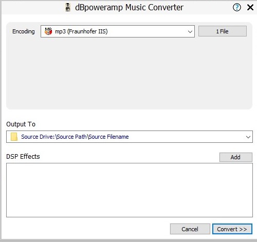

    Hi, I have the latest release of dbpoweramp installed and I have installed the FHG codec extension without any issues.
    However, when I go to convert a .WAV I'm not seeing the correct screen according to the screenshots on the codec page.
    If I try to convert the file it gives me the following error message:
    Error converting to mp3 (Fraunhofer IIS), 'C:\Users\Simon Langham\Downloads\feb 2021 ADID edit.wav' to 'C:\Users\Simon Langham\Downloads\feb 2021 ADID edit'
    Error: Unable to load encoder 'mp3 (Fraunhofer IIS)'. [dBCoreConverter::dBCoreConverter]
    Do you have any idea what' causing this since the codec installed without any issues?
    Thanks in advance.

    Re: Problem with Fraunhoffer CODEC
    Have you installed the 64bit version of dBpowerAMP as this codec is 32bit only?
