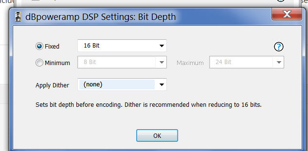

      "If" I convert those from 24bit to 16 bit ALAC and apply the DSP bit depth, are these settings that come up by default, how I would keep them? Or would I need to make other selections in this area? If so, can you tell me how I would set it?
Name:	DBPower amp DSP settings.jpg
      Again, I will convert .flac/.wav 24bit files to ALAC 44100/24bit as well. Doing so should be okay, right? And keep the file sounding good?
      Thank you!

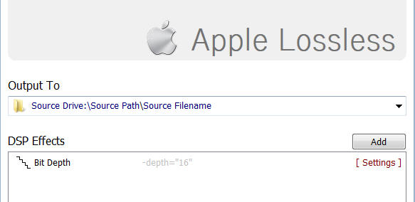

        BTW, now that I went to check this DSP setting you told me about (which I was unaware of, so thank you), I see that is is now occupying the window. I'm worried that this is going to apply now to any song I might convert. How do I remove this?
Name:	DSP settings DBPA.jpg
          Re: ALAC settings with .FLAC files
          You can right click on it and select remove.

            I realized that my Sonos app won't play 24bit files. (Their new S2 app will, but the guy at Sonos cautioned me against using it yet because there have been a lot of issues/problems with that). So for now, I need to be in the 16bit world. So if I convert my .flac or .wav files that are (e.g.) 96/24bit to ALAC files, what is the best setting for this DSP setting you suggested? Meaning, what's the setting you'd most recommend? I posted the image of that area where you add the DSP bit depth thing. Do I keep the Fixed at 16 (remember, I'm converting FROM FLAC [B]to [B]ALAC. The .flac is the 24bit file.
            So Fixed is 16?
            Do I set any minimum/maximum, and if so, what would I choose?
            Do I use the Apply Dither? If so, which one do I choose, triangular or rectangle?
            The goal is to get the ALAC file to 16 bit, but keep the lossless from 24 bit on the FLAC to a minimum.
            I think you may have misunderstood my first questions on this. You said; "Converting to ALAC or FLAC preserves the existing bit depth and sample rate." I don't see any option to change ALAC to 16bit when I'm converting from the 24bit .flac file. Is that what the Bit Depth DSP is for? And if so, then how do I set things per my notes direction above on which settings to set?
            Thank you SOOOO much!
              Fixed with triangular dither.
              Yes set bitdepth will change the bit depth whilst converting.
