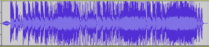

    1) The original stereo file looks like this:

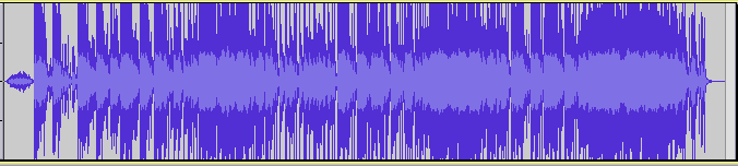

    2) Once converted in Mono using the Converter:

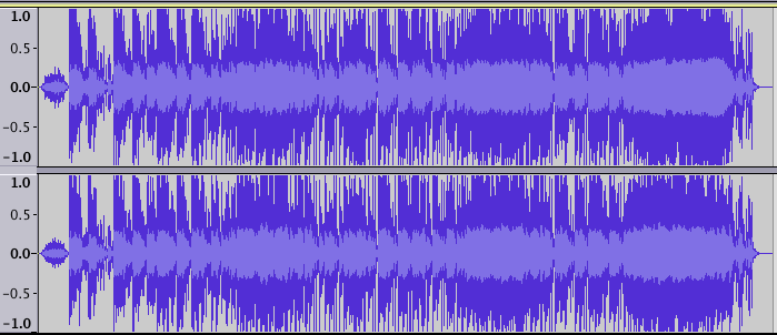

    3) To compare, the same Stereo file converted in mono (with a third-party software: Audacity) looks like this:
    Does anyone know what is wrong? Thanks for your help.

          Possibly, but you would have to experiment with the Channel Mapper settings to try and replicate what Audacity is doing and then decide whether you are happy with the results.
          I'm not familiar with Audacity, but I guess the stereo to mono function is applying a gain change, to avoid potential clipping. Whether the amount of gain change is set by the user, set based on a reference level or simply a fixed amount, you would have to check the Audacity documentation.

              Re: Stereo to Mono conversion : sound ends up saturated?
              Depending on the audio, you effectively have 2 channels which become one, and if the channels perfectly add together then you would need to set the gain at 0.5, but for most music that will be too quiet.
              You are best:
              DSP Effect: Bit Depth >> Floating point
              Channel Count
              Volume Normalize: Peak to peak
              Bit Depth: 16 bit (with dither)
