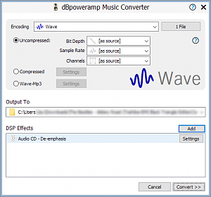

    Hi. Just want to sanity check..... is the R17 De-Emphasis DSP effect for Music Converter working?

      Re: R17 - is the De-Emphasis DSP effect working
      maybe I am doing something wrong..... maybe someone could try R17 and confirm this DSP effect works
          I use Sox command line deemph as a baseline. I am not writing here in this thread to suggest the DMC De-Emphasis curve is different or worse than Sox. I am writing here to suggest that the De-Emphasis DSP effect does not actually run, even though it appears to do so.
          I have tried converting to/from WAV/FLAC and it makes no difference.
                  @Spoon No, in fact I have Windows Defender disabled via registry hack.
                  For comparison, the Volume Normalize DSP works, but De-Emphasis does not.
                  I've been a customer of DBPA/DMC for a long time, this is the first time I've tried a DSP and it flat out does nothing. I realize De-Emphasis is new for R17....
                    Fixed for the next update
