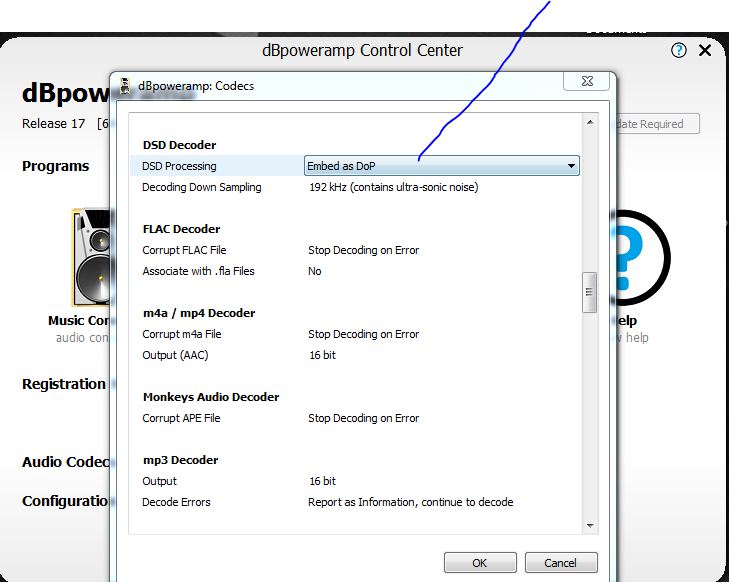

    In the setting of dBpoweramp-Codec-DSD-SACD i choose DSD over PCM DOP IN THE DROP DOWN WINDOW - THEN 192 Khz IN THE OTHER DROP DOWN WINDOW.
    THE OUTPUT FILE IS ALWAYS 176 Khz
    If I use PCM instead of DOP I can get the 192 khZ file in the output.
    BUT i am interested in the DOP setting and getting a DOP 192 Khz or even a DOP 352 khz.
    Am I tripping? Please assist

      Re: dsf convert to dop 192 KhZ - dBpoweramp limits me to dop 176
      Thanks for your time.
      I used Iso2Dsd to rip dsf files from SACD ISO
      I have been trying to convert a dsf file to flac
      In the setting of dBpoweramp-Codec-DSD-SACD SEE IMAGEClick image for larger version
      Do the settings in dBpoweramp-Codec-DSD-SACD have anything to do with converting dsf to flac ?
        • 46228
        Only the first option, if you set to embed as DOP then if the frequency is not the 192kHz (which is in the 2nd box), this shows the DOP is working. You have tried to play the flac file?
