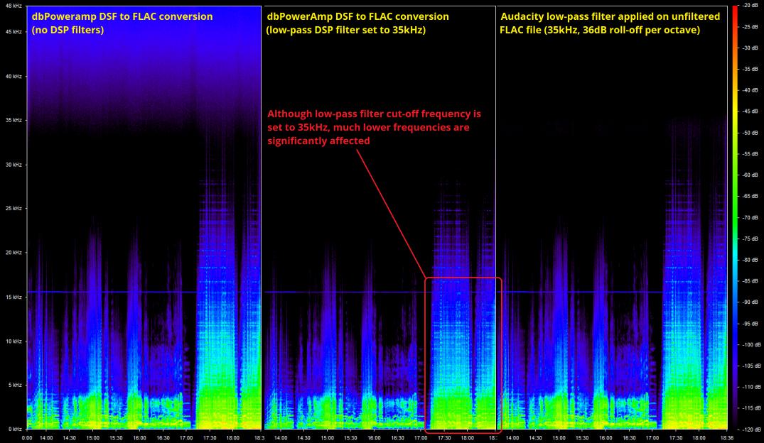

    I converted a set of DSF tracks to 24/96 PCM (FLAC) using dbPoweramp. After conversion, I analyzed the spectrum of the resulting FLAC files and expectedly found that there are lot of undesired ultrasonic frequencies above 35kHz.
    To filter these frequencies, I re-converted the DSF files, this time with applied a DSP low-pass filter set to 35kHz, which perfectly elliminated the ultrasonics from the PCM tracks. However, I found that much lower (audible) frequencies were affected as well, which was strange.
    For comparison, I post-processed the unfiltered dbPoweramp FLAC file using Audacity and its Low-pass filter effect, configured to 35kHz with steep roll-off (36db per octave). The resulting spectrogram of the audible spectrum now perfectly ressembled the original file, however without undesired ultrasonics.
    To illustrate the differences, I combined spectral fragments of these three scenarios into a single image:
    Is this an expected behaviour from the dbPoweramp low-pass filter or I did something wrong?
    Thanks!
    Re: Low-pass filter during DSF to FLAC conversion
    We will take a look at it.
      Any news regarding this issue?
        We did have a look, the improvement is more of a longer term fix and will not make R17.1 which is out in the next few weeks.
