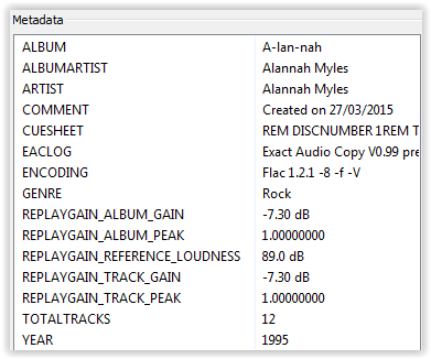

    I have run all my FLAC image files through the Replaygain DSP using EBUR128 - 18 LUFS for track and album gain.

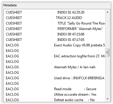

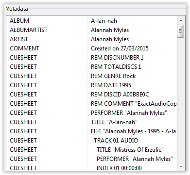

    This has worked fine but in the process 2 of my tags (CUESHEET AND EACLOG), which contained text files have become split into separate tag lines for each row of text
    Before I did this the "extended tags" screen in MP3Tag for an image looked like the first image (5th and 6th tags). Afterwards both the CUESHEET and EACLOG tags have been split into multiple lines (images 2 and 3)

    Sadly you have {CR} in your tags, our programs use this internally to signify a multi-artist, etc item. We can look at excluding these tags from multi-item writing.

        Yes CUESHEET and EACLOG.

          R17.1 will preserve these carriage returns in the tags for CUESHEET and EACLOG
