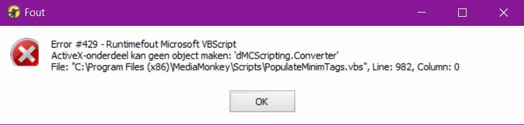

                I consistently get the error
                Sorry for the Dutch language error message, but translated roughly it says:
                ActiveX component can't create the object 'dMCScripting.Converter'
                What am I doing wrong, here? Is this maybe a case of 32 vs. 64 bit? Or something completely different?
                  • 46043
                  Re: Bug: dMCScripting.Converter COM interface broken in R17.0
                  It is likely Media Monkey does not have permissions to create activeX objects, or run the script.
                  Media Monkey is 64 bit?

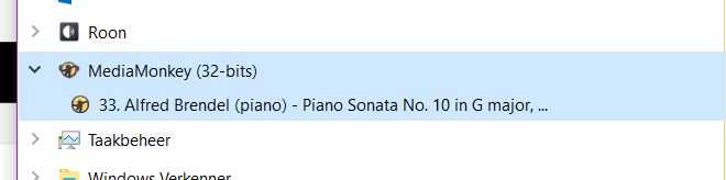

                    I'm a little bit surprised to find that my MediaMonkey runs in 32bit mode, if I can believe the task manager:
Name:	MediaMonkey 32 bits.JPG
                    My Windows 10 installation works in 64bit architecture, so I always thought MediaMonkey would also run as 64bit. Maybe I should investigate this further...

                      There has been at least one other person who tried to do this from within MediaMonkey and succeeded, as can be read here Seeing this was 10 years ago, he probably ran a 32 bit version of dBpoweramp?
                      My Mediamonkey runs in 32bit mode. It appears there never was and never will be a 64bit version.

                        • 46043
                        We have never tested 32 bit calling 64 bit. It is not possible to have a 32 bit scripting in 64 bit Windows.
