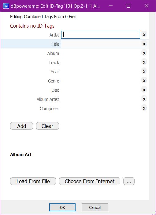

        It is independent from audio format. It does not work for flac, dsf, mp3, aac seems to be a general problem with the shell extension. Example attached

          The issue seems to be in passing the filenames to the tag editor. You are using Windows File Explorer?

                    I have exactly the same problem, also with 32bit dbPoweramp R17 on Windows 10 x64.
Name:	empty fields in ID tag editor.JPG
