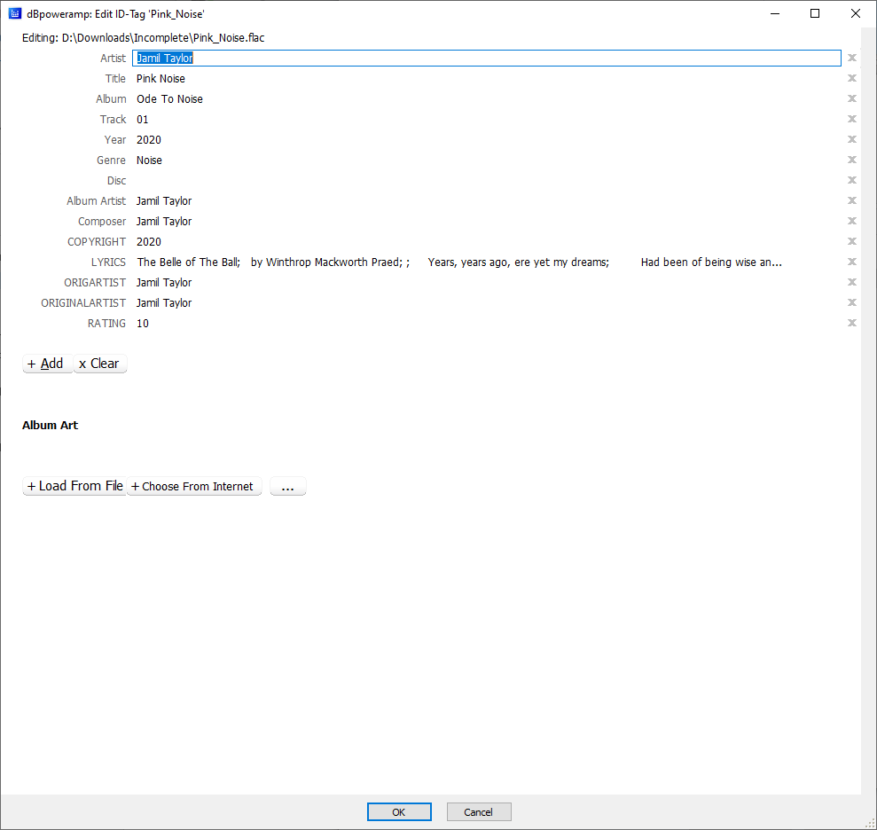

    I have most of my audio files containing a rating within the tags. The rating is stored as an integer from 1 to 5. dbpoweramp will sometimes multiply this value by two. It does not always do this though. I am not sure why it does this at all.
    Attached is an example screenshot.
    The tag content within the file is RATING=5.

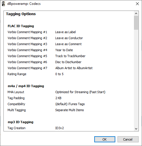

    dBpoweramp Control Centre >> Audio Codec Options
    there you can set the range for FLAC rating.

      Re: dbpoweramp Sometimes, But Not Always, Doubles The Stored Rating
      This is how it is currently set in my options. I have never changed this:
      This is the latest reference version of 16.6.
          This actually has happened to me quite a bit with many files.
          Here is the particular file in Tag&Rename:
          Here is the tag info shown in a hex editor:
          As stated in my initial post, the rating shows as RATING=5. The question is how is dbpoweramp displaying a rating of 10? This happens quite often.
