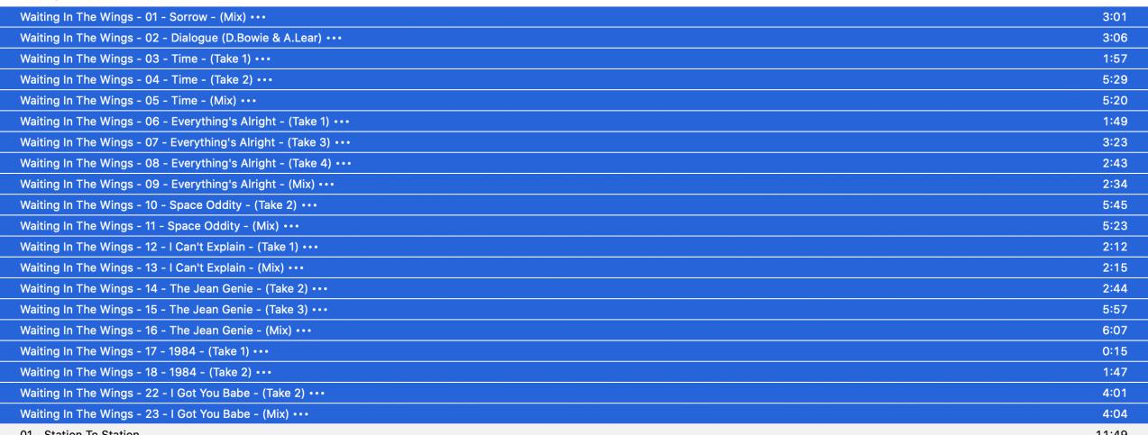

                        Currently, the tracks in iTunes look like this:
Name:	Screenshot 2019-12-18 at 18.21.08.jpg

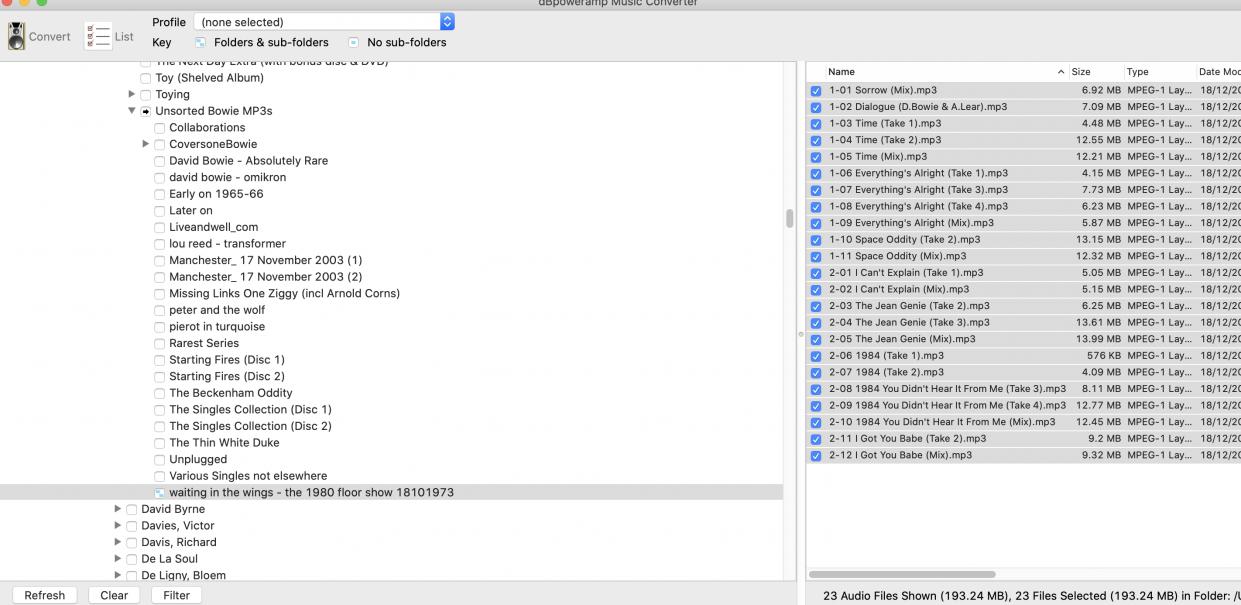

                        When I go to Batch Convert & select them, we're looking at the files in my finder & they are named correctly:
Name:	Screenshot 2019-12-18 at 18.20.56.jpg

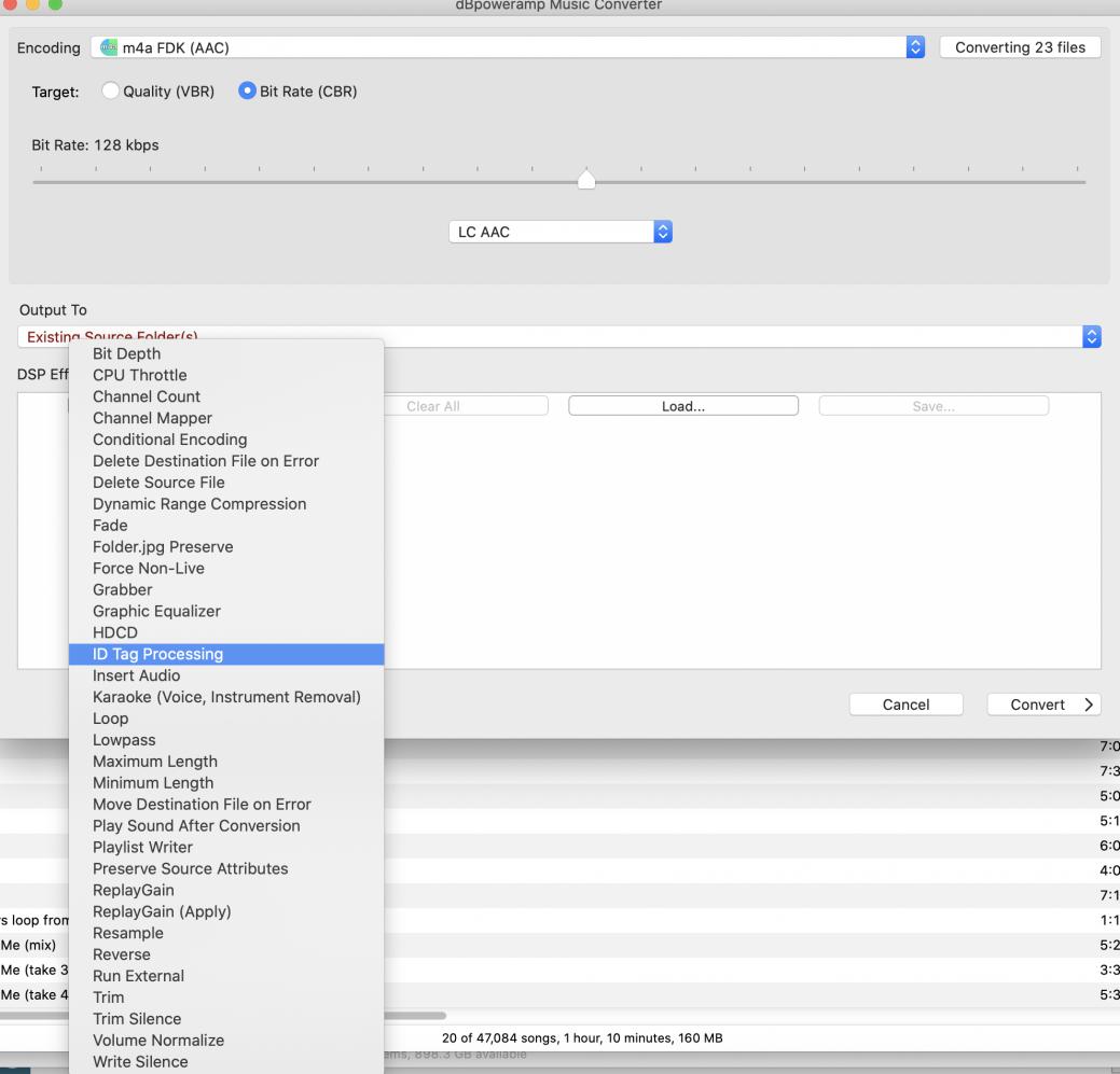

                        When I click on the DSP list, I don't see the tag editor you're referencing.
Name:	Screenshot 2019-12-18 at 18.22.07.jpg
ID:	294172Click image for larger version
                        As mentioned previously, the Tag Editor codec is an EXE file & not usable on my Mac.
                        Apologies again for being thick as a whale omelette if I'm missing something.
                        Also, this makes it look as though I'm also going to convert the files to AAC format which I don't need to do as they're already MP3s.

                          In your last screen shot, where it says "encoding to" (at very top of page) instead of AAC there, that's where the "filename to tag" would showup instead. This is NOT a DSP you add halfway down that page. That may be why you're not seeing the correct DSP. It must be selected at the top where you have "ecode to" or "convert to". But if it's not in the dropdown list, you don't have it installed. I have no idea whether it is part of the Mac version. If not, there's a way to do the same thing in mp3tag program.
