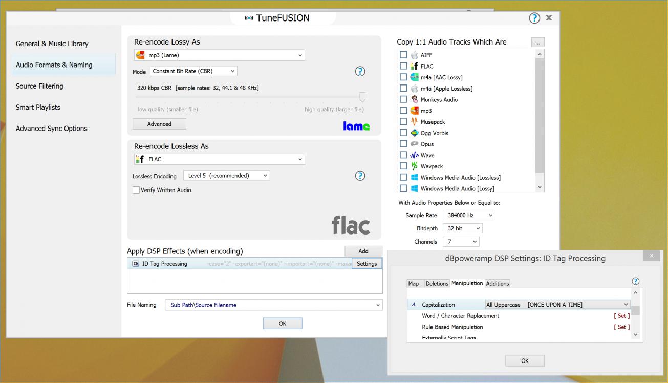

                    Example using Tag Processing to capitalise (just for illustration purposes).
Name:	Screenshot 2019-06-26 at 14.16.30.jpg
Name:	Screenshot 2019-06-26 at 14.16.50.jpg
                    Result:
                    Code:
                    $ ls -l /sourcedir/filename.flac
                    -rwx------@ 1 userid  staff  10366245 26 Jun 14:14 filename.flac
                    $ ls -l /destinationdir/filename.flac
                    -rwxr-xr-x  1 userid  staff  10357321 26 Jun 14:18 filename.flac
                    $ exiftool /sourcedir/filename.flac | grep Artist
                    Album Artist                    : Susan Manoff
                    Artist                          : Sandrine Piau, Susan Manoff
                    $ exiftool /destinationdir/filename/flac | grep Artist
                    Observations:
                    1. File is being rewritten (probably re-encoded)
                    2. Nothing has been capitalised: the Tag Processing did not work
                    3. Bizarrely, Album Artist has disappeared from the output file altogether.

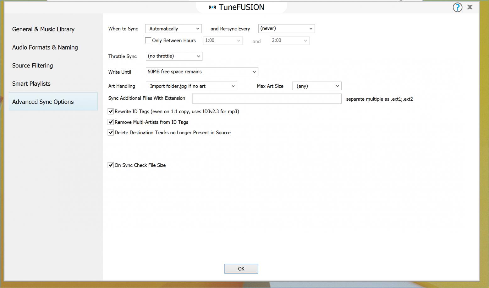

                    New discovery: if I turn off "rewrite ID tags", the Tag Processing now works!
                    The option to save art to "cover.jpg" does nothing (that was one of the cases I was using as a simple test) so that may be broken in some other way, but never mind.

                              A few things to note:
                              If there is any 1:1 copy then DSP Effects are not run.
                              If you have 'Rewrite ID Tags' then this option overrides ID Tag processing and the original tags are written.
                              Both of these issues will be fixed for next update.
