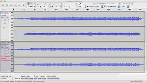

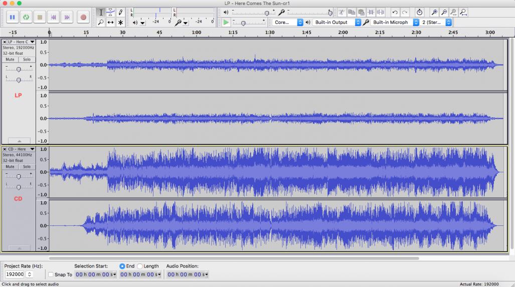

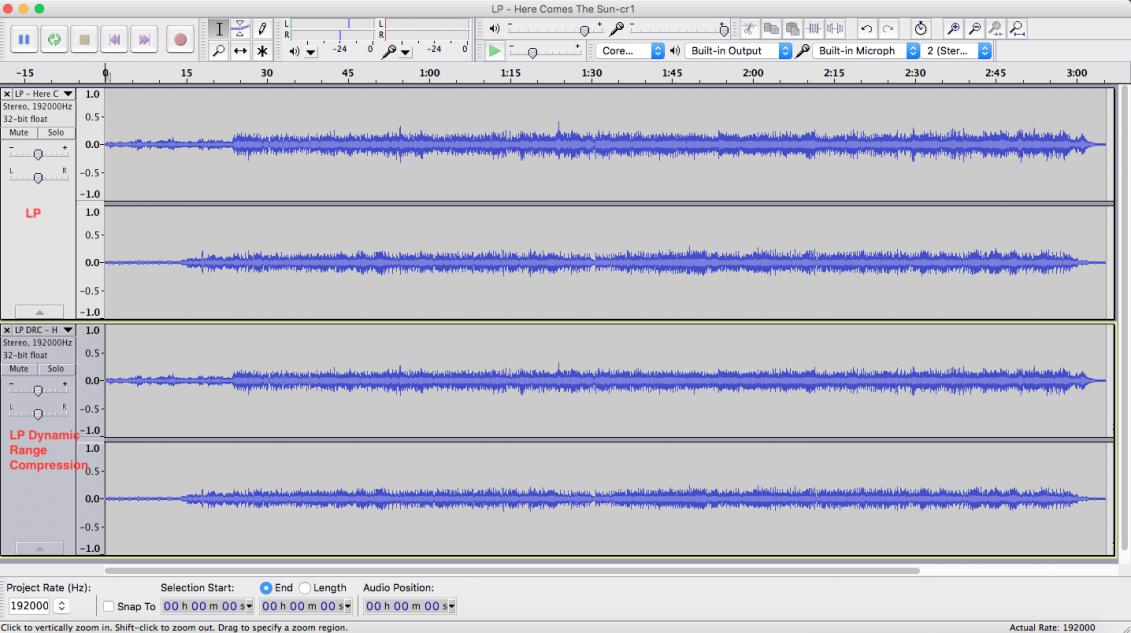

      I may have a no win here. I've been researching this over the course of the day and any post-rip corrections I do will, as I understand it, negativly impact my recordings. All of my tracks were done as lossless FLAC rips from LPs at 192K/24 bit. Are there any corrections I can do in boosting the volume without any negative impacts? My review and test of using dynamic range compression out of the box further compresses the sample track. If this is the right solution, what are the settings I need?
      I attached some Audacity screenshots comparing the options (so far).
