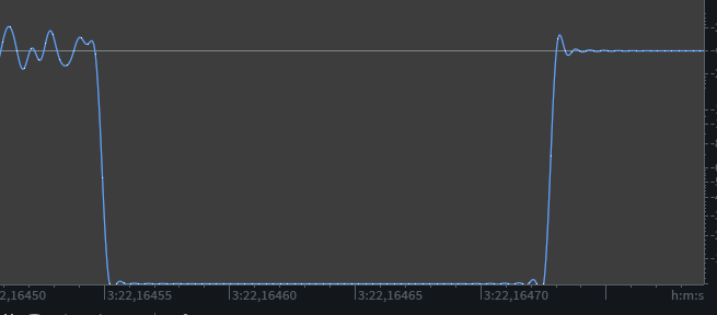

          I did some test conversions, DSD64 (*.dsf) files with cleared tags to wave 32bit floating point at 352,8kHz and the click (0dB FS) in the right channel comes up.
          To me that looks like a switching click, in special with that high amplitude.
          Converting the same source files with JRiver MC did not show this issue.
          G.

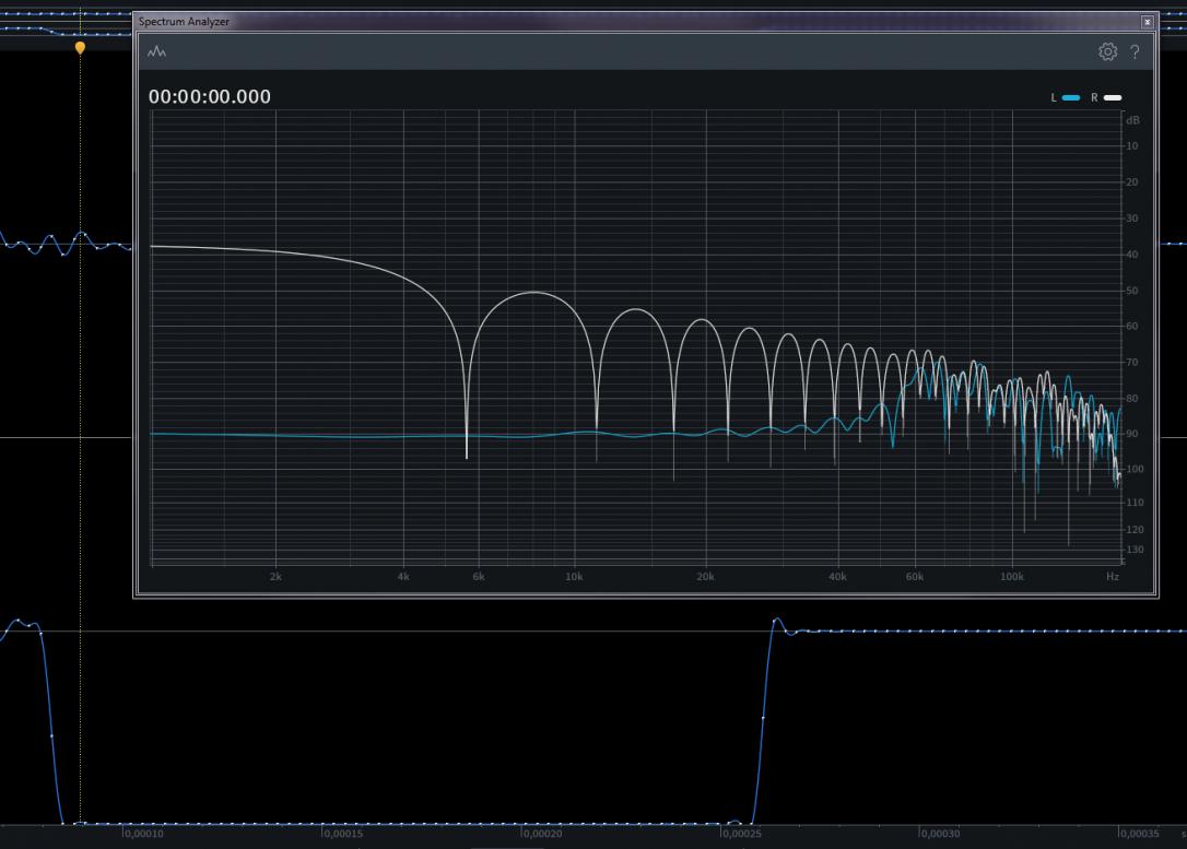

            2nd Pic

              Re: DSD to PCM conversion buggy
              Sorry I do not know what to suggest, we did not write the DSD decoder.
              • Kempy
                • Dec 2018
                • 11
                Is the DSD decoder sox-DSD based ? I found the same behave when converting DSD64 to PCM with sox-DSD.
                I switched to Foobar with the new SACD plugin for such conversions, that works fine.
                G.
                  It is possible they both use the same decoder yes.
