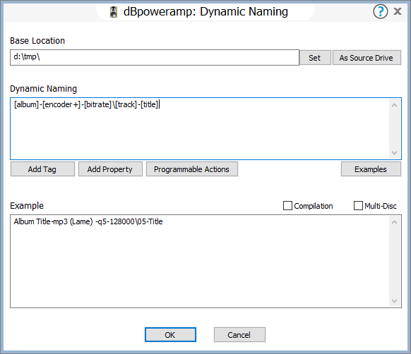

                      • 1908
                      Re: Using &quot;Encoder Settings&quot; in Dynamic Naming Scheme?
                      Did you use Multiencoder or only Lame?
                      Here is a screenshot taken on a Windows system.
