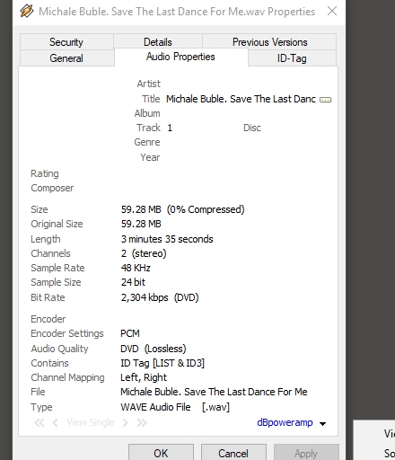

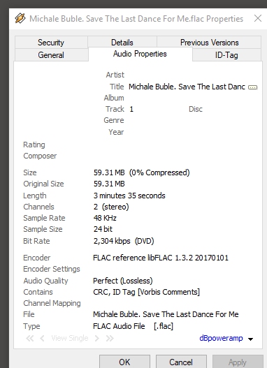

            Please see screen shots of wave file / Flac converted fileClick image for larger version
Name:	M Buble Flac.jpg
ID:	293845Click image for larger version
Name:	M Buble Wav.jpg
            I have converted a Wav file 48k at 24 bit to Flac at 100% uncompressed format, Same file size.
            This is an example of a music file converted at 100% 24 bit.
            Your comments would be welcome.
