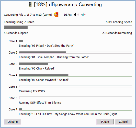

              Re: FLAC to MP3
              This is from Music Converter help:
              "dBpoweramp Reference encodes using multiple CPU cores at the same time (in the above example 7 cores are used), however multiple CPUs are sometimes not used depending on audio format (such as a lossless format, as the hard disk is likely to be the bottleneck not CPU)."
              You can click the Option button at the bottom during a conversion. I haven't figured out how to get to it any other way.
