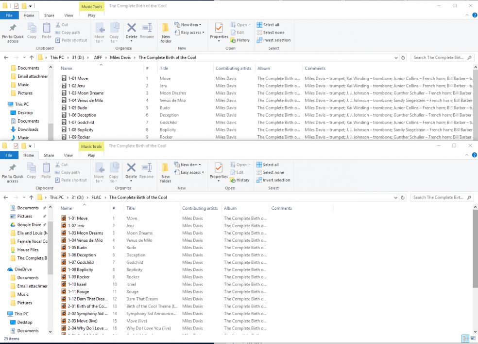

    I just converted a few Miles Davis CDs. My recent practice is to add the musician credits to the comments field (seeing none other as a better fit). When I converted the AIFF files (which had the commnets) to FLAC, none of the comments carried over. Why is that?

            I should have read your original post more closely. I have been converting AIFF to FLAC for some time now.
            I checked my files and did a test conversion, and confirmed that comments are carrying over. However, while I can see the FLAC comments using Edit Id-Tag, for some reason File Explorer won't display them, as shown in the example you posted.

              Re: Convert Music with Commnets
              It is just Windows not following the FLAC specification on ogg vorbis tagging, see:
              as to how to put dBpoweramps tag reader instead of the broken Windows one in place.

                  • David W
                    • Oct 2011
                    • 66
                    So that I fully understand, Windows 10 won't display the comments embedded in FLAC files, but those comments are in fact embedded in the FLAC files. Yet, Windows 10 will display the comments embedded in AAIF files. So if I have a need to convert the FLAC files back to AIFF, the non-displayed comments in the FLAC files will be displayed in the converted AIFF files?
                      Correct, you can test with 1 file.
