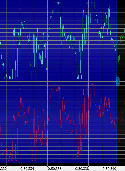

          Re: Ripping/Quality of music HEEEELP
          Most modern CDs have clipping hard coded into them.
          Clipp.png is a snapshot of the song Crazy by Gnarls Barkley in wave format.
          My solution for such recordings is a super expensive program called stereotool. It's really hard to figure out how to configure, but has the best declipper I've ever seen.
          Sometimes it recreates the clipped wave to be much louder than the rest of the song making the song sound very quite. For this I made a custom peak leveler with python.

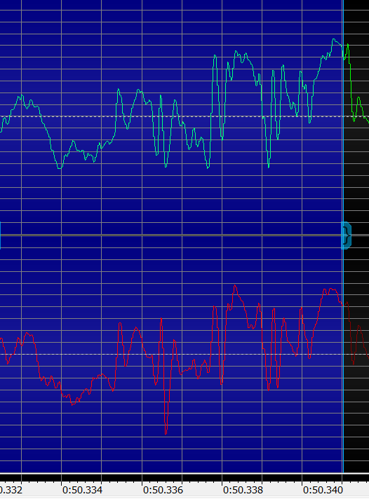

              For reference, here's a shot of the same song in the same spot at the same scale, after it's been processed.
