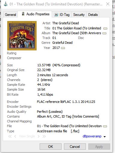

    HDCD DSP not working
    Windows 10 x64 all updates
    DbPowerAmp 15.3

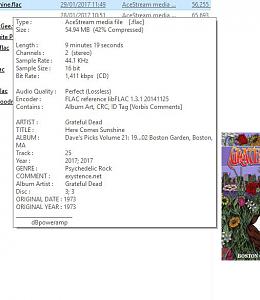

    Never seen this before. See attachments

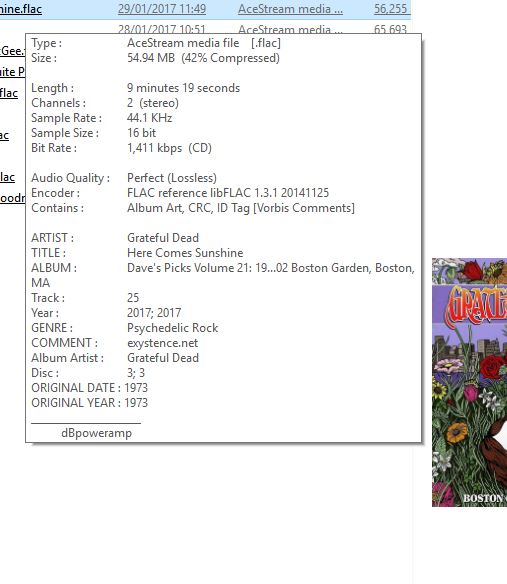

      Re: HDCD DSP not working

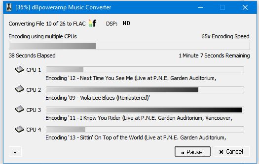

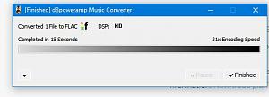

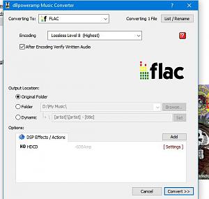

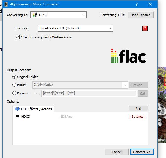

      As per second image. No conversion has taken place. Have converted in place (as I usually do) - no go - then converted to a new folder. No go. Never seen this before.

        I just tested with one of my Grateful Dead HDCD disks. I converted with the HDCD DSP and it did convert the flac files to 24 bit flac files (as expected). I'm running Win 8.1 and dbpa 16.1 (64 bit)
                    OK. Deffo a problem. New release from dead.net, Dave's Picks 21, ripped straight Flac to disc, also not converting to HDCD. Am going to reinstall

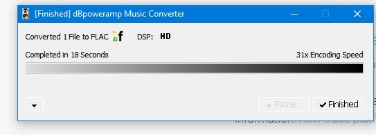

                        Something is wrong here. I have Windows 10 Pro 64-bit, running dBpoweramp Music Converter R15.3 and have over 100 HDCDs.
                        Running the HDCD DSP on my HDCD tracks creates 24-bit files everytime HDCD tracks are detected. On completion, when I click the Finished button, the following info window is displayed:
