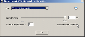

            Where is the window size setting? I don't see it:

              I'm sorry, it is called "window length" and it is only available when choosing volume normalization (not replay-gain) with the mode "Adaptive (EBU R128)"
                Got it - https://i.imgur.com/zsfrrRX.png - thanks.
                Thanks for your report. I'll avoid this windowed version!
