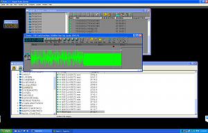

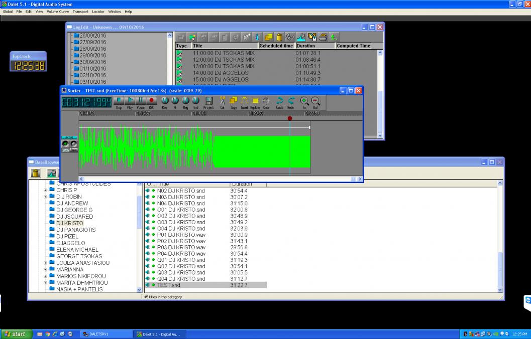

    Dear sir, I am using DALET 5.1e and tried the DALET Codec from the dbpoweramp (ver. 12, 16, 16.1) and from different computers to convert from .wav or .mp3 to .snd. The conversion works but at the last few seconds (from 5 to 15 sec) the sound is cut or disappears. When you open the file with the DALET Editor you see the photo that I'm sending you. If you open the file with Sound Forge the file plays out completely but at the last few seconds the waveform is missing despite the fact that you can still hear the sound playing out. Can you please help? Besr Regards
