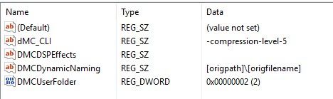

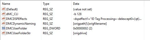

          I have the same problem:
          Source Drive:\...
          sometimes changes to
          Music\...
          I used to "Convert to" from file explorer, but when I have more folders to convert, then the Batch converter, mostly converting mp3 bit rate and normalize.
          I do not remember that I used flac at all.
          Here is the registry after I changed back to source drive... again, as I used to do in this case:
          HKEY_CURRENT_USER\SOFTWARE\Illustrate\dbpoweramp\d MCCodec\FLAC
          HKEY_CURRENT_USER\SOFTWARE\Illustrate\dbpoweramp\d MCCodec\mp3 (Lame)
            • 46139
            Re: How to have the program remember my chosen path for conversions??
            If you not use flac then this is correct, next time it changes look at the registry (for the mp3 item), if you have CCCleaner, it will delete this value.
            • hopalong
              • May 2007
              • 40
              #21
              Thank you, I disabled cleaning dBpoweramp in CCleaner, so it doesn't remove DMCUserFolderStr, the issue is resolved.
