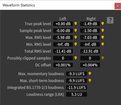

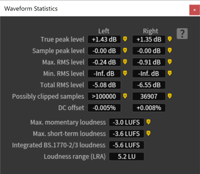

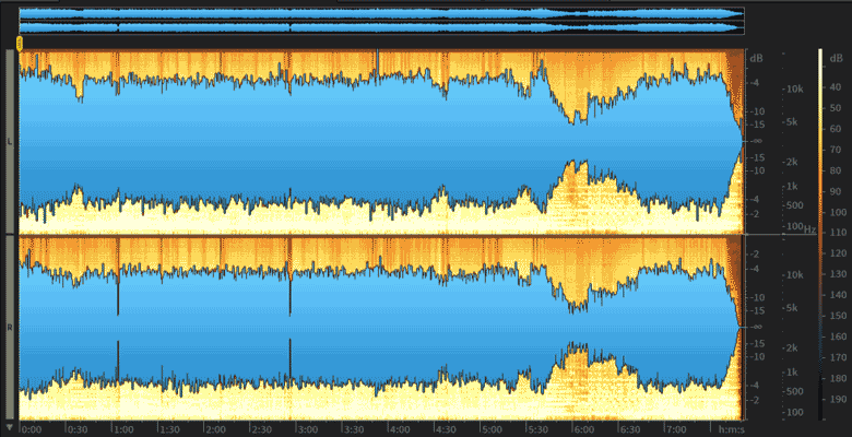

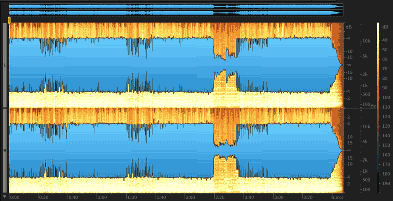

    What was interesting is, and this is probably dating myself, I remember the QDesign audio codec back from Quicktime 3 had always suggested lowering the input volume of audio for the encoder to 70%, or -4.2 dB. I did this using the Normalize DSP in dBpoweramp, decoded them back to FLAC and then analyzed the files. The results are quite interesting:
    Normal input (no volume change) - Waveform Statistics of the FDK AAC HEv2 at -m2 -a1 -p 29
    Normal input (no volume change) - Visual Waveform of the FDK AAC HEv2 at -m2 -a1 -p 29

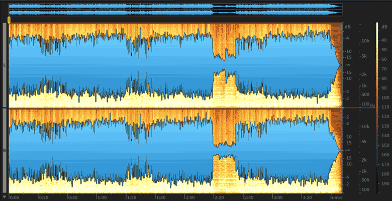

    -4.2dB input (70% of original Volume) - Waveform Statistics of the FDK AAC HEv2 at -m2 -a1 -p 29

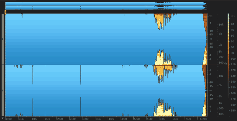

    -4.2dB input (70% of original Volume) - Visual Waveform of the FDK AAC HEv2 at -m2 -a1 -p 29
    -4.2dB input (70% of original Volume) - Visual Waveform of the FDK AAC HEv2 at -m5 -a1 (Full Quality Low Complexity)
    It seems there is a pretty clear advantage to lowering the input volume when encoding to low bit-rates, especially since lossy codecs are bit-depth independent (no dynamic range is lost). I did notice when doing this with LAME at V9, all the hard squeaky artifacts were gone after changing the input to 70%. Of course, it still sounded bad :D
    It also appears there may even be an advantage to lowering the input a bit even when encoding at 256 kbps AAC, although not as dramatic.
    Spoon, any thoughts on this? I wonder what is going on here and if whatever IS going on here could also be used to declip audio!?!

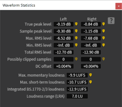

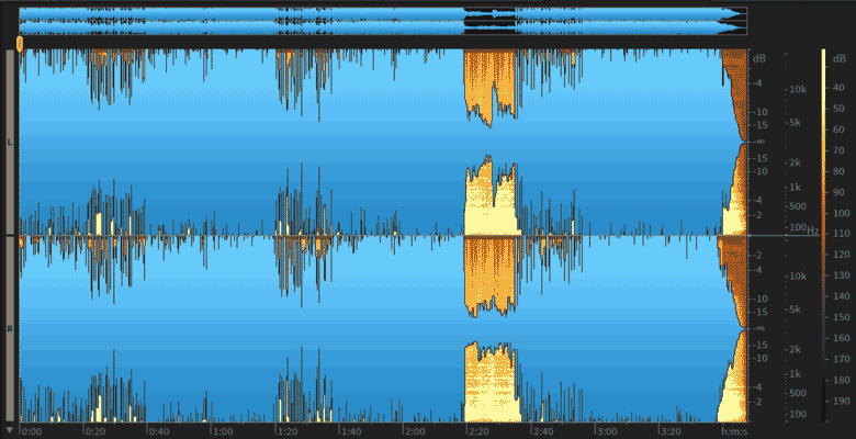

    I just tried this on Death Metallic, the LOUDEST CD on record. The input volume needs to be at -6.4dB, or 47% of original to avoid clipped samples, so I think that's where I'll leave the normalizer for encoding low bit-rates.
    No volume change
    dBpoweramp Normalize DSP set to lower volume by -6.4dB before encoding

        Re: -4.2dB (70% volume) makes a dramatic difference at low bitrates for Lossy Encoder
        -4db is almost halving the signal, hence the reduction in bitrate (as there is less to encode).
        Well, I think there is a lot more going on there... 16 bit is theoretically 96 dB dynamic range (really more than that with dithering) and most new music uses only about 10-12dB of the available range due to the aggressive dynamic compression to sound louder (but REALLY fatiguing on the ears), so really, a -4.2 or even -6.4dB change is only going to lower the dithered noise floor that much further with 16-bit audio. I suspect dithering noise is the only thing you are showing the encoder less of. Take a look at the waveforms as well. The encoder clearly has a de-clipping affect. The Dynamic Range tool shows Death Magnetic goes for a DR of 4 to a DR of 9 after lowering the input volume to -6.4dB before encoding. Pretty big difference. Interestingly enough, using a high bitrate and the Low Complexity model does not have as much of a declipping affect, probably due to maintaining a more faithful representation of the original signal, where the low bitrate version is much more of a synthetic re-creation?...
        I suspect the real reason for the bitdepth reduction is inter-sample clipping tends to cause high frequency distortion, which is expensive to encode, but then I am just speculating... Still the affect is interesting, no?
