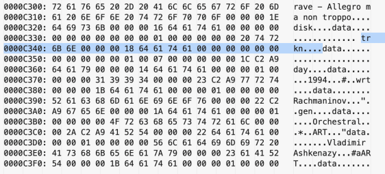

    Trkn is written:

      Originally posted by Spoon-
      Trkn is written:
      Thanks for this - I stand corrected :-)
      However, isn't this supposed to be the track number field?

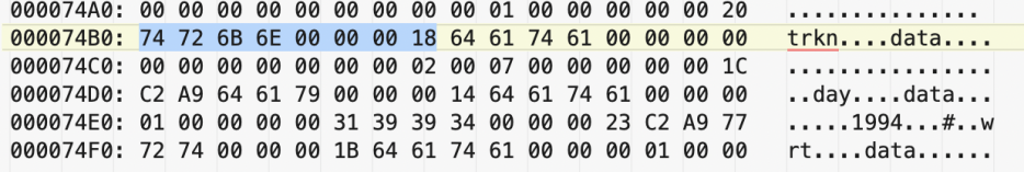

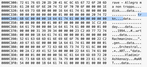

      - Your example shows a hex value of 0x18 which (if my maths is right) corresponds to a value of 24. But I'm getting the same number in all my ALAC files, regardless of the true track number, e.g.,
      here's track 1:-
Name:	Screenshot 2026-06-15 at 14.19.34.png
      …and here's track 2:-
Name:	Screenshot 2026-06-15 at 14.27.29.png
      So where is the true track number stored? Or am I missing something here?!!
        That would be field length, the track number follows data
        • dcp10
          • Jun 2026
          Ah, that makes sense! Looks as if the field length includes both the 'trkn' and the 'data' tags. That then gives the correct track numbers (1 and 2) for my two excerpts.
