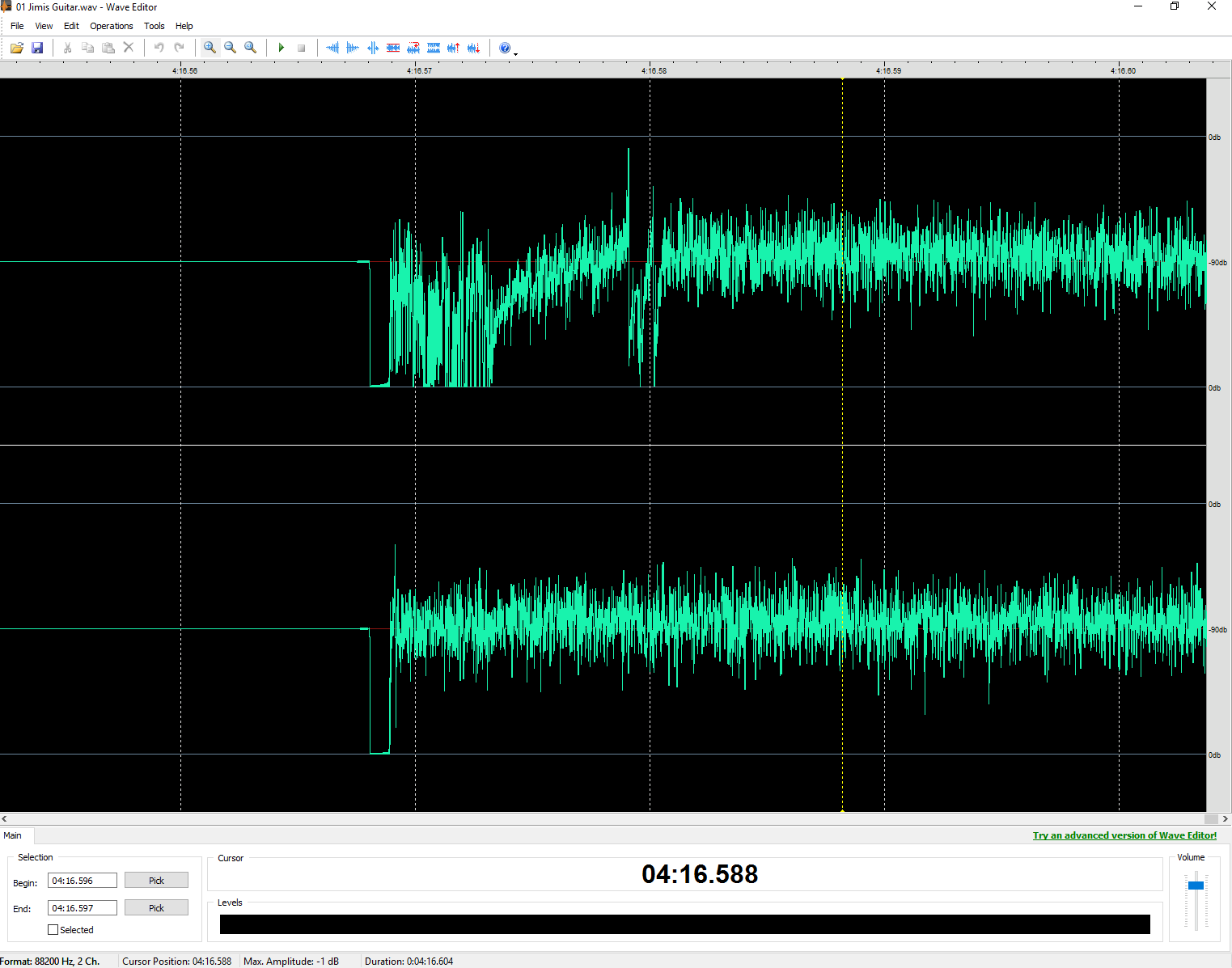

Name:	Screenshot 2016-02-01 22.00.45.png
          Analyzing with a wav editor there is a very short full dc offset in the resulting .wav. (see picture)
          Thank you for investigating further.
          Last edited by Starwolf1; February 01, 2016, 09:19 PM. Reason: wrong image at first sorry.

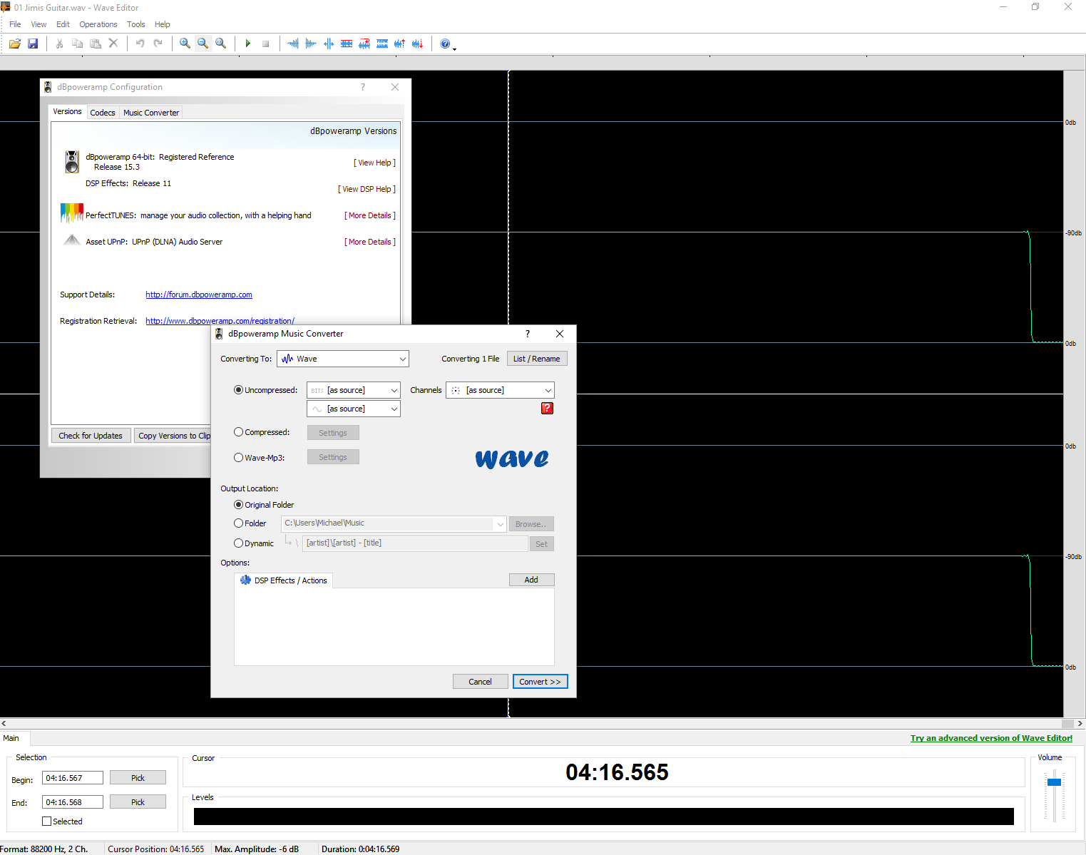

Name:	Screenshot 2016-02-01 22.18.14.png
