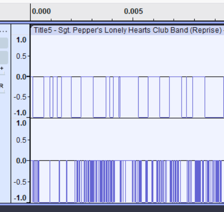

    I have been using dBPoweramp R14 music converter for many years. I recently replaced my PC with a new laptop and decided it was time to update dBP to the latest version. So I now have dBP 2025-07-01 64 bit on Windows 11. The first time I have tried to use this to process some music files I am getting badly distorted (unlistenable) output files. They are playable but consist of loud noise. Looking at the waveform in Audacity they contain square waves between 0 and -1 (i.e. no waveform positive above zero) - see screenshot below. The file sizes are also not correct (much smaller) based on comparing to previous output files that are ok.

    The operation I am doing is to convert 6 channel FLAC files to 2 channel FLAC files using these DSP Effects:
