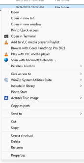

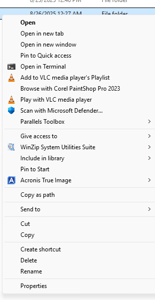

          I am a total Newbie at this stuff. Found a post on the forum from mville He said using the Batch converter Click on the top level folder, right click and select batch converter. I do n Click image for larger version
Name:	Screenshot 2025-08-26 003328.png
ID:	334763 ot have batch converter in my drop down list. Click the convert button etc. ... I am not able to do the first step. I do not understand what to do with the code words you gave me
            • 46085
            Run the batch converter from dBpoweramp Control Center.
            On the converter page, select 'the box below 'output to' and for naming choose:
            Preserve source path, and choose the folder where you want them saved.
              • 1911
              Did you setup dBpa to show rightclick menus?
