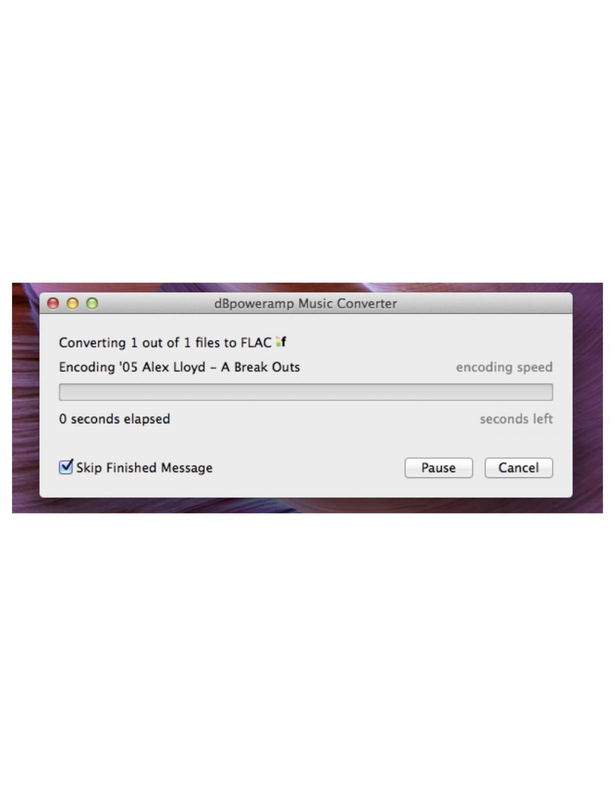

    I have some problem FLAC files that do not display the ART even though it is embedded as well as in a folder.jpg. It is often track 1 but can be any track number. ALL tracks in the album are encoded at the same time with the same Art. I have tried deleting the inflicted file and re ripping but this does not eliminate the issue, perhaps because it is stored in the same location? If I re rip as M4a or convert from FLAC to M4a and delete the original FLAC file it does correct the issue but having a single M4a track in an album of FLAC causes them to display out of order as my Cambridge player displays based upon Meta Data. I thought that converting the file back from M4a to FLAC may resolve both the art issue and the display issue but the file will not convert back to FLAC. Is there a limitation preventing a FLAC to M4a back to FLAC conversion? I also tried AIFF but it also will not convert back to FLAC.
