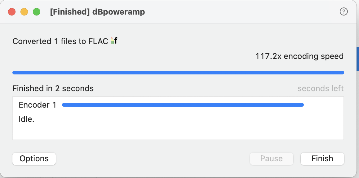

    I recently started using dBpoweramp and I'm loving everything so far. I have ripped a bunch of CDs and I just started converting them. I'm having an odd issue, though: the converter never actually finishes. At the top of the conversion window it says "Finished" but within the conversion window it says it still has "x seconds left" (x has differed from track to track). The image below will give a better idea of what I'm talking about.
    I have tried a test conversion and the same thing happens. I have also tried different formats (e.g., MP3, FLAC, etc.). Additionally, I have tried both batch conversions and individual conversions and it doesn't make a difference: the converter hangs at the end.
    I have checked the destination folder and there are indeed converted files there, so maybe everything is just fine. Even so, I wanted to check to make sure. Also, the error log is not appearing, and it would be nice to know if there were errors during the conversion!

              Looking at the image, it looks like just a display update issue, the button 'Finish' has enabled which shows the conversion has finished. We will investigate why for next version.

                Sounds good! Ultimately, my concern was that something had gone wrong with the conversion process, but hearing from you that the conversion has truly finished removes that fear. Thank you!
