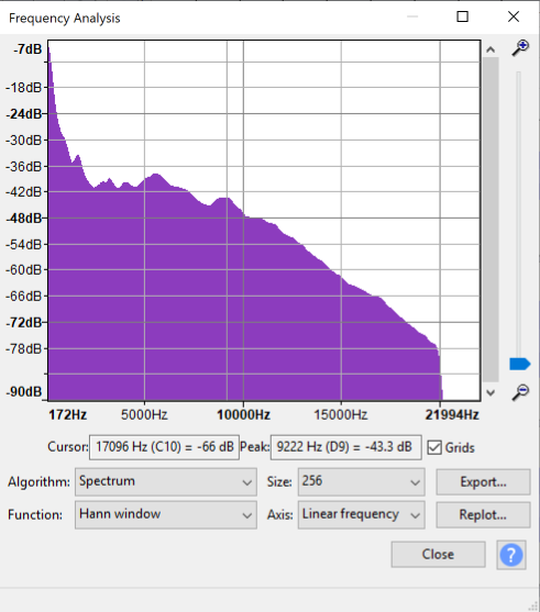

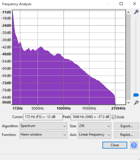

    Tested, converted a flac file to mp3, and generated the following two plots in audacity -18 and -14, there is 4 db difference between them.

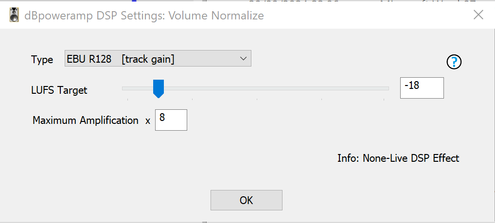

          You must have an old version of dBpoweramp, on that page it now shows (see image)

            Spoon, I have the current version.
            Here is where I'm confused - when I read the help file for DSP Volume Normalization and see, "EBU R128: a newer standard of ReplayGain, the average loudness is calculated and the volume is adjusted. This method adjusts the audio. Internally the audio is calculated to a -18LUFS level which is adjustable" ----- if the slider is set to 0, does that mean it will use the internal -18 or, on your screen shot, do I have to set the slider to -18 to get the value of -18, or set the slider to get my desired -14 and so on.
            What does the slider do with the "internally calculated -18?" If the slider is set to 0, does it raise the internal -18 to 0?
            Sorry to be a pest, I just don't fully understand what the program is doing with the internal value and how to use the slider.
            Thanks so much for the help.
              It should not be set to 0, in the latest version, the version released today definitely has LUFS target if EBU is selected, so best use that one. The old version used to have target volume which was not the best as 0 was -18.
