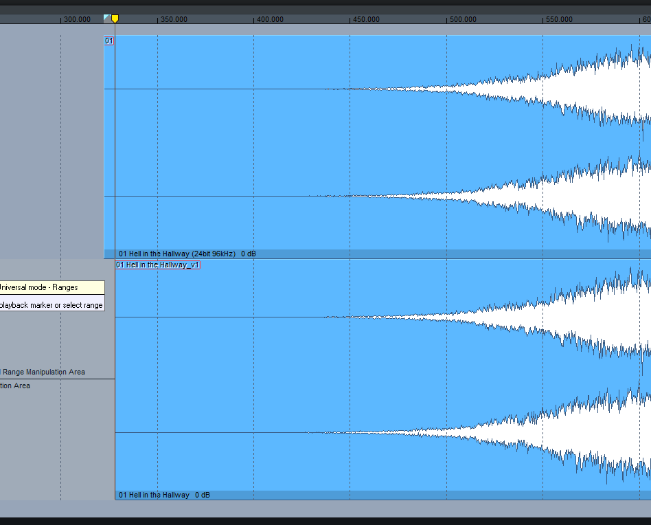

          Here is some more interesting information.
          In all graphics, the output of Music Converter is in the upper lane. The source is in the lower lane.
          A crucial bit of information: all of my conversions include a VST3 plug-in at the end of the chain. And it MUST be the VST part of the job that is causing this problem.
          Comparing the original 24-bit 96kHz source against a version where Music Converter simply 'converts' the file to 24-bit 96kHz (but adds a brickwall limiter with a gain of +0.0 and a ceiling of -0.3db FS) the files are different in several key ways.

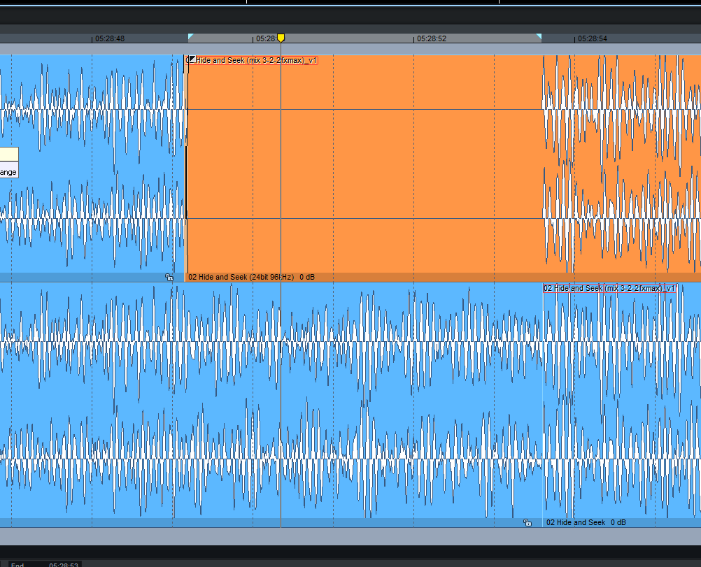

          • 5.704 samples are added to the beginning of the output file.
          • 5.704 samples are deleted from the output file - that audio content is gone!
          Start of file. The top, which represents the output, is padded with almost six samples that shouldn't be there.
          01 Samples added at top
          End of file when aligned against true content. Note audio content is deleted entirely. (Not the second track "Hide and Seek" is not accidentally positioned to cover the track on the left, the first track "Hell In The Hallway" Ends exactly where the waveform ends, and the second track matches at the start where it aligns in this screenshot).

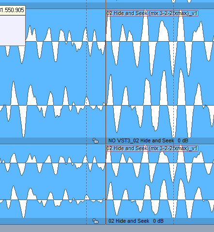

          Here is what happens when I run the same job to convert the 24-bit 96kHz file to 24-bit 96kHz. Spoiler Alert - the conversion is correct.

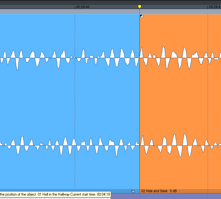

              Here is what the source audio looks like. The files start and end at a zero crossing
